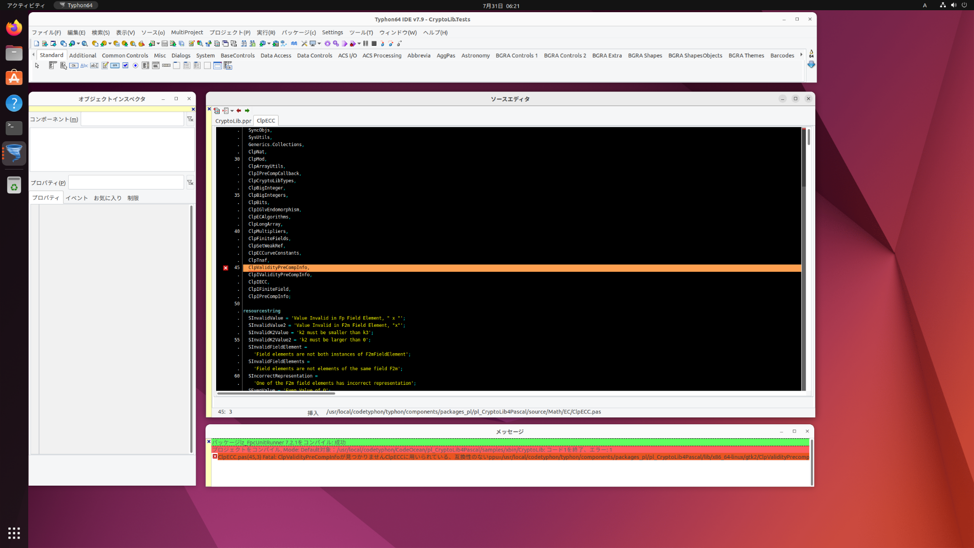

I have encountered a compile error with CryptoLib.
It is happening on Ubuntu 22.04 LTS on CT7.8 and CT7.9.
Ubuntu 20.04 could not be installed because GLIBC is out of date.
/usr/local/codetyphon/CodeOcean/pl_CryptoLib4Pascal/samples/all_tests/CryptoLib.Tests.ctpr
I just opened and compiled the
It went through on Win64 with no problems.
Sorry for the Japanese, but I am attaching a screen shot of the error.
The following error is shown in English.
ClpECC.pas(45,3) Fatal: ClpValidityPreCompInfo not found, used for ClpECC, incompatible ppu=/usr/local/codetyphon/typhon/components/packages_pl/ pl_CryptoLib4Pascal/lib/x86_64-linux/gtk2/ClpValidityPrecompInfo.ppu, package pl_CryptoLib4Pascal".

CryptoLib compile error 4 years 3 months ago #17164
Replace with new fixed version

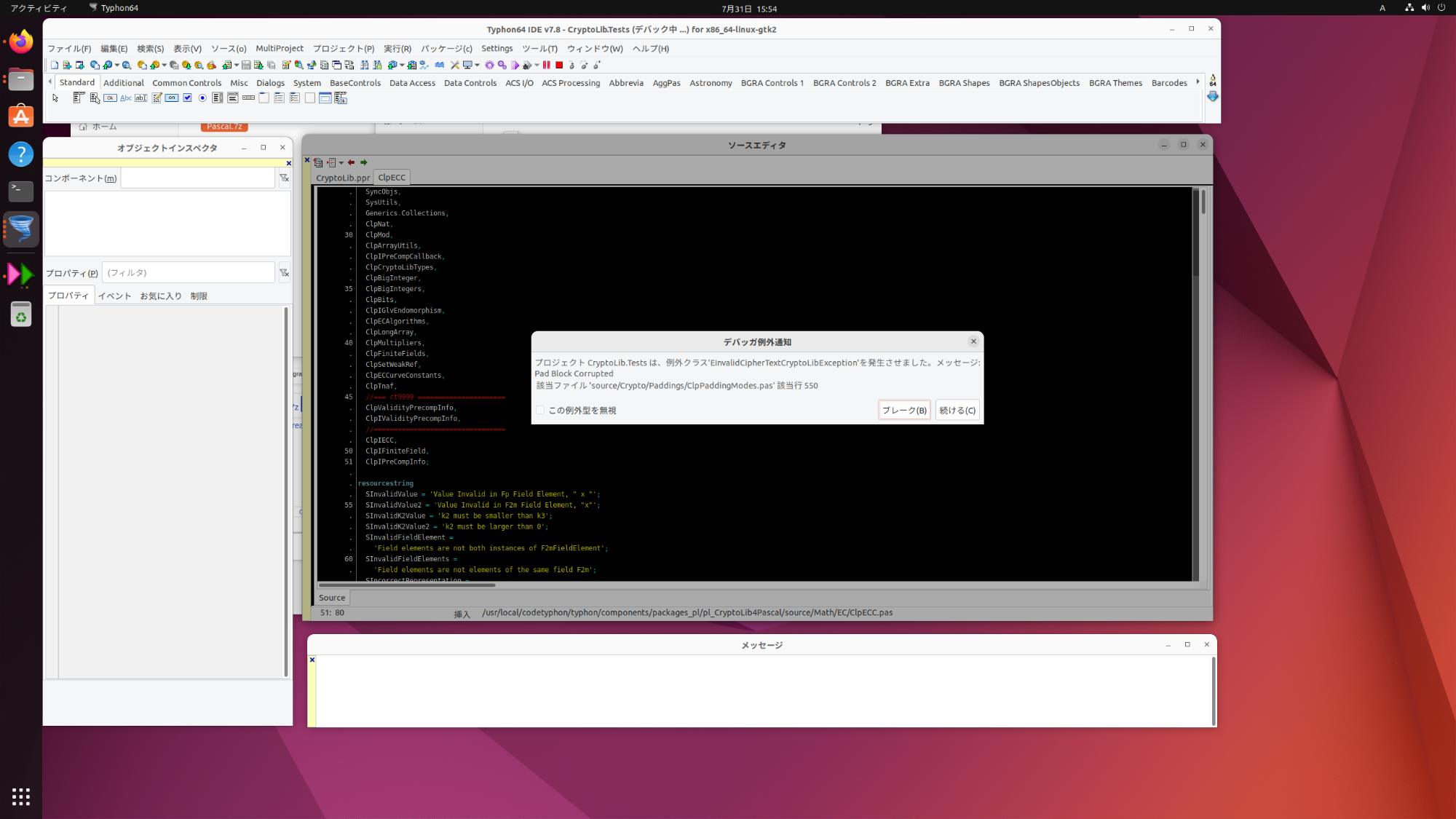

However, when I ran the test, it hung.
After a while, the debugger gave the attached exception notice.
English.
Project CryptoLib.Tests raised exception class 'EInvalidChipherTextCryptoLibException'. Message: Pad Block Corrupted
Corresponding file 'source/Crypto/Paddings/CLpPaddingModes.pas', line 550
I kept pressing "wait for response" on the executable and eventually the test seems to have completed.

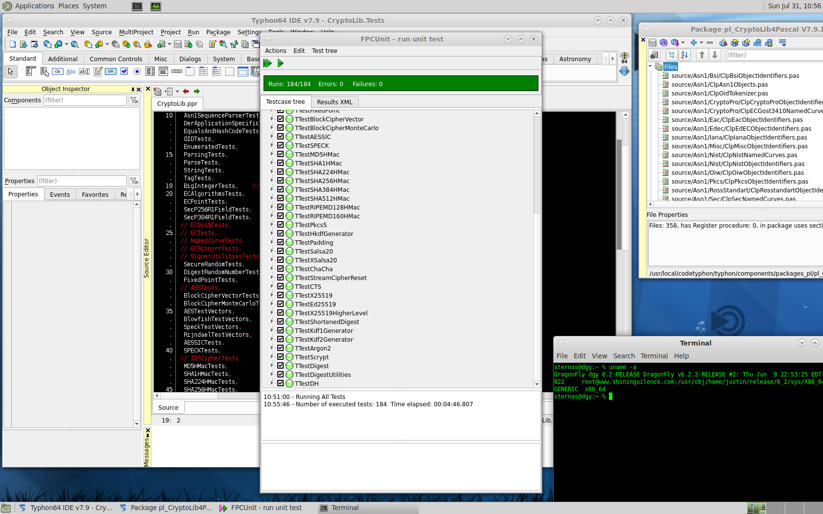

For your info
In build cycle of new LAB CT release,
we run without debug the test app of pl_CryptoLib4Pascal package
on latest DragonFly OS ver 6.2.2
with MATE desktop and TyphonIDE build for QT5 platform.
Without errors.
Same result and  with TyphonIDE build for GTK2 platform.
