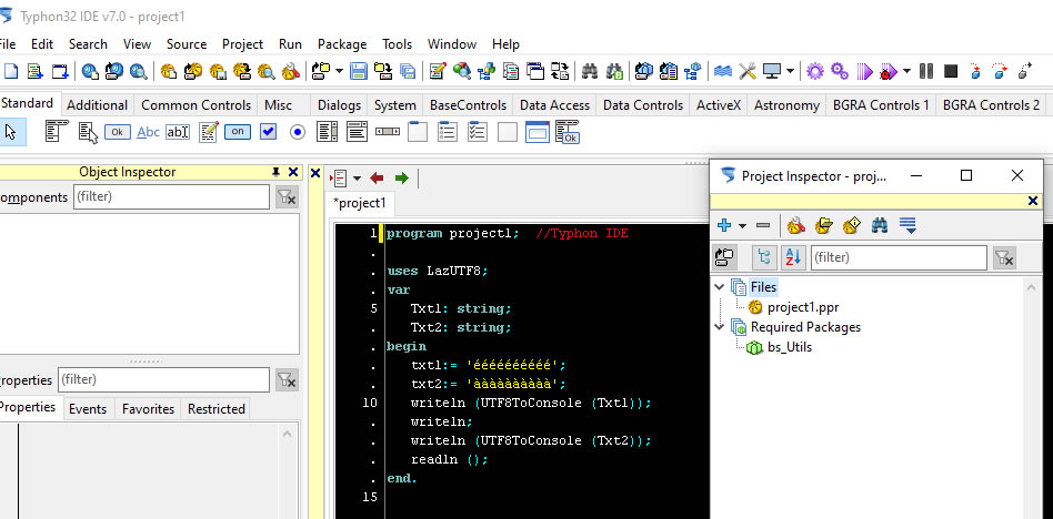

This new version ( CT 6.9 ) is a bit complicated to use the old libraries, usually on console I use ASCII characters like 187 = ╗, in Lazarus used the lib LazUTF8 with the UTF8ToConsole function to get around screen print errors, example:
uses LazUTF8;
var
   Txt1: string;
   Txt2: string;
   txt1: = 'éééééééééé';
   txt2: = 'àààààààààà';
   writeln (UTF8ToConsole (Txt1));
   writeln;
   writeln (UTF8ToConsole (Txt2));
   readln ();

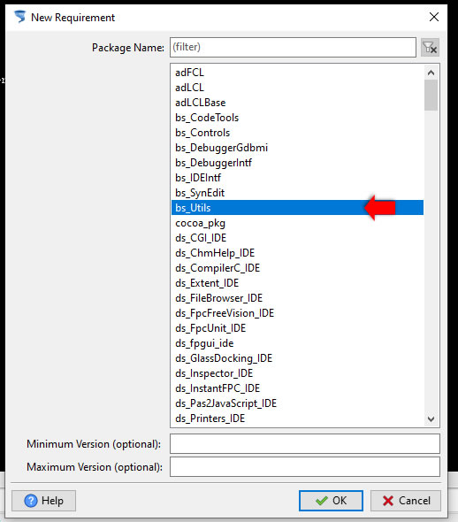

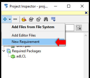

you can use the same as Lazarus methodology
add to your project bs_utils pkg to use LazUTF8 unit
look in to attach file sample zzz2.zip

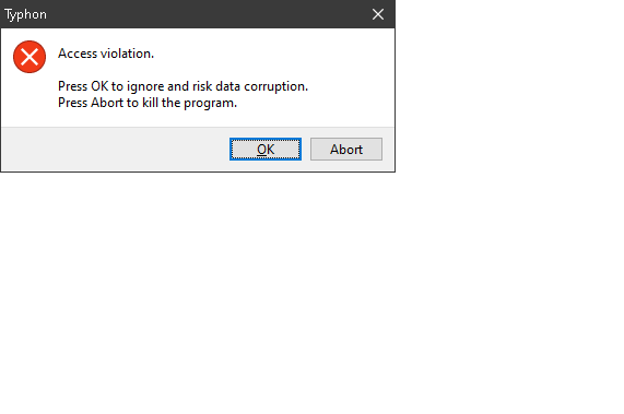

After compile and instal bs_utils, crashing on started CT and CT no more open :(

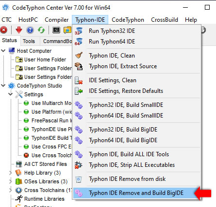

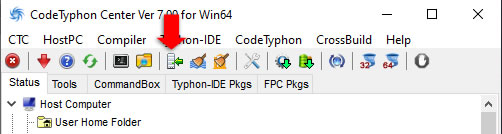

Restore Defaults Setting from CTCenter
Or
Remove and build Typhon IDE from CTCenter
Unzip zzz2.zip and open sample project
bs_utils pkg is in Typhon IDE
Simple ADD to your project the bs_utils pkg to use LazUTF8 unit.
The following user(s) said Thank You: Joel Demetrio
