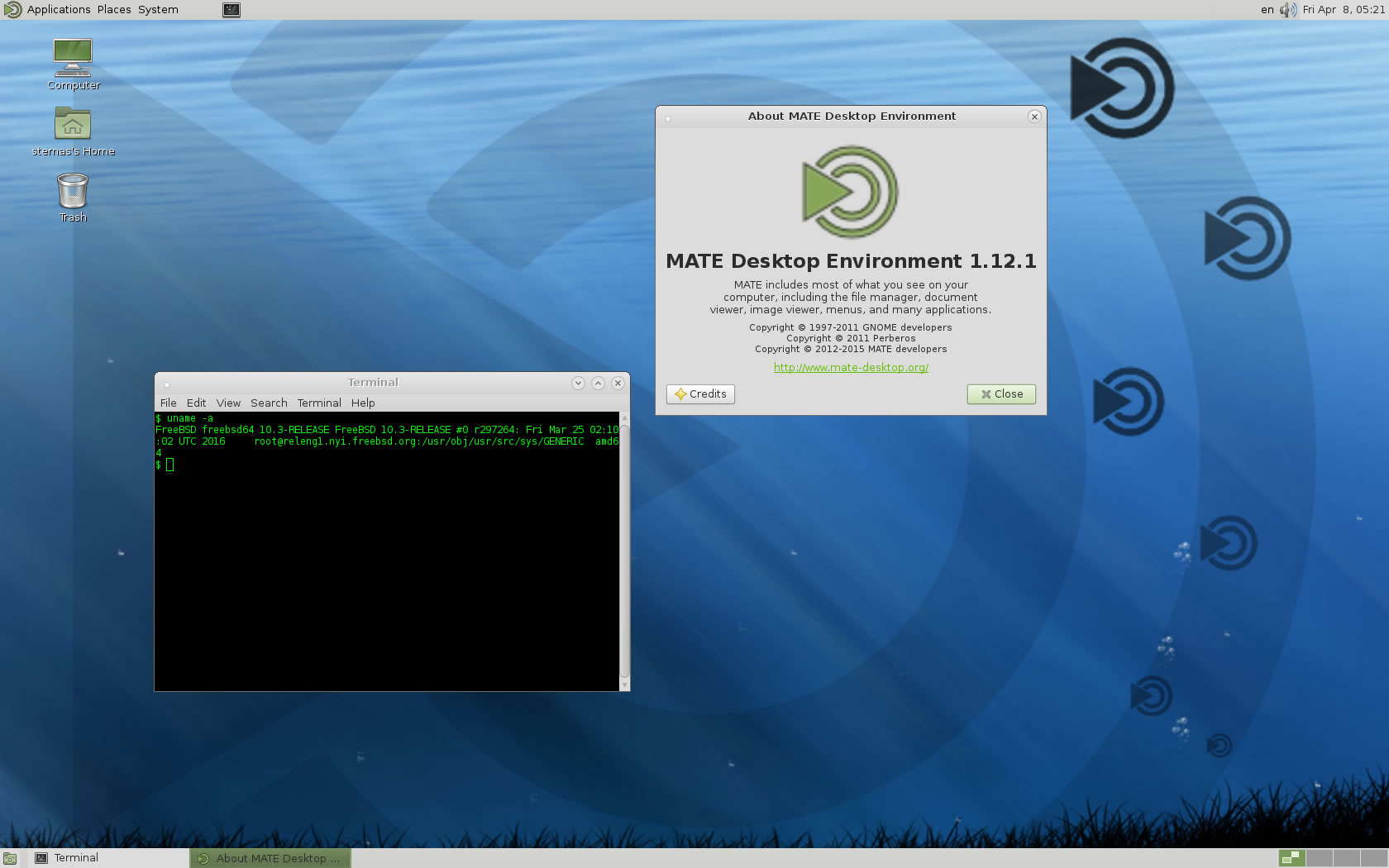

[LAB] CodeTyphon on FreeBSD 10.3 10 years 6 months ago #9422
We test LAB CodeTyphon ver 5.80 on
FreeBSD 10.3 info

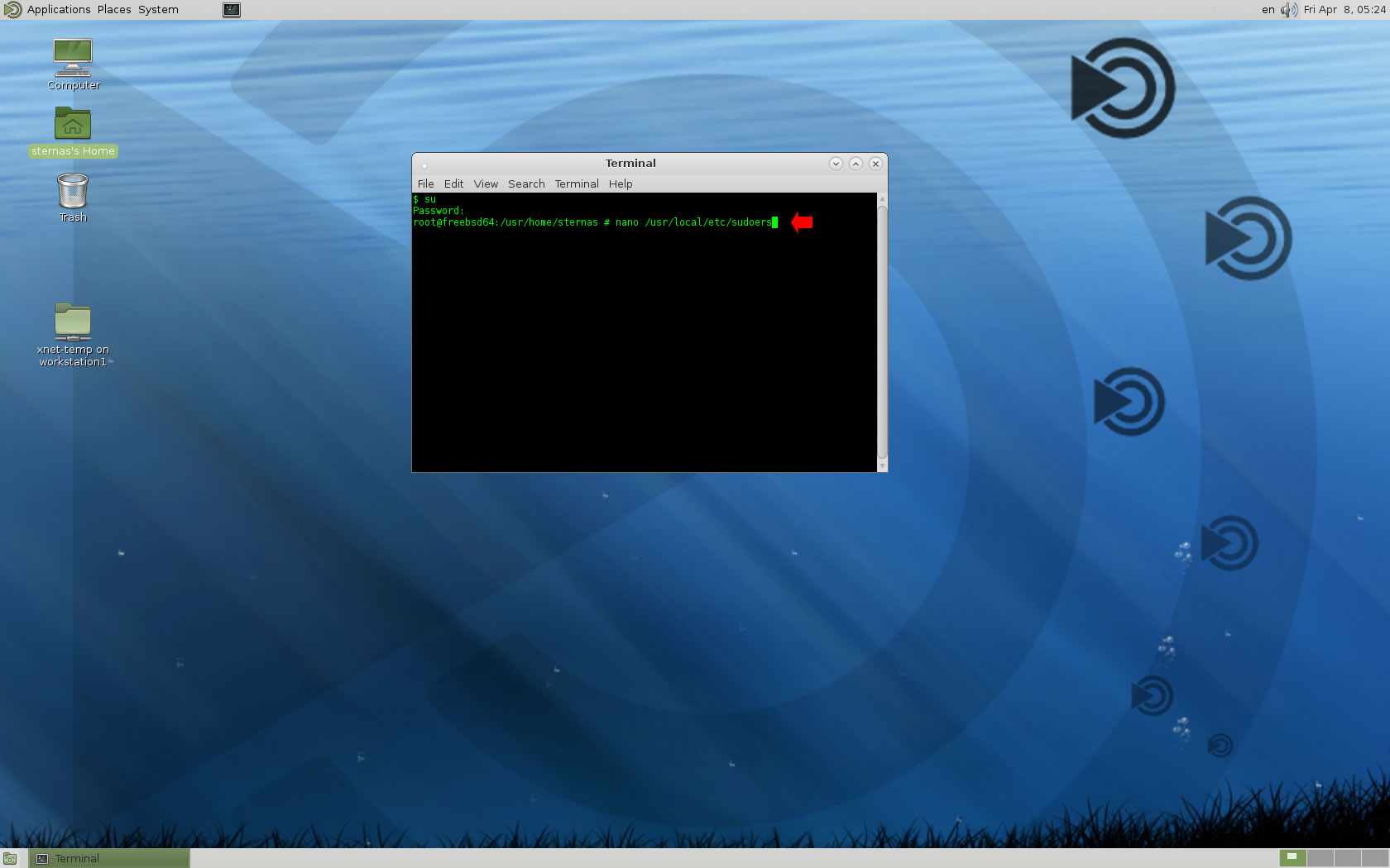

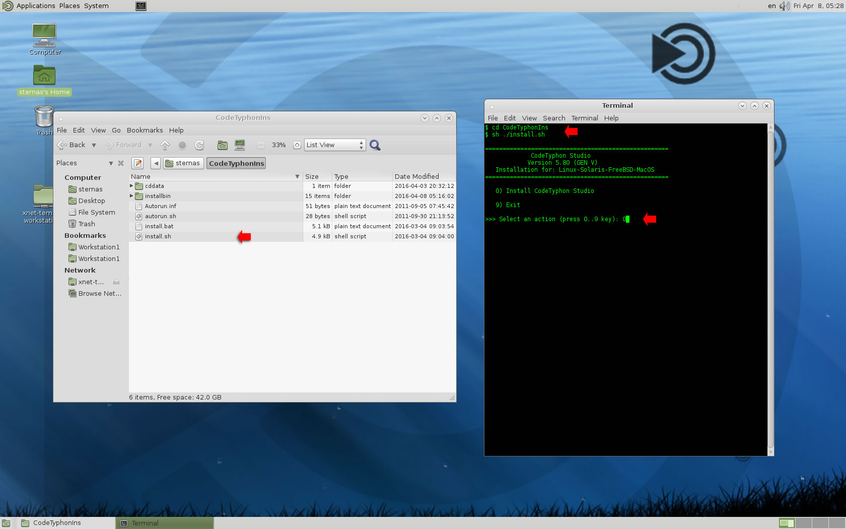

Some screens from CodeTyphon Installation and Build procedure for GTK2:
(All actions are the same as any other CT host OS)

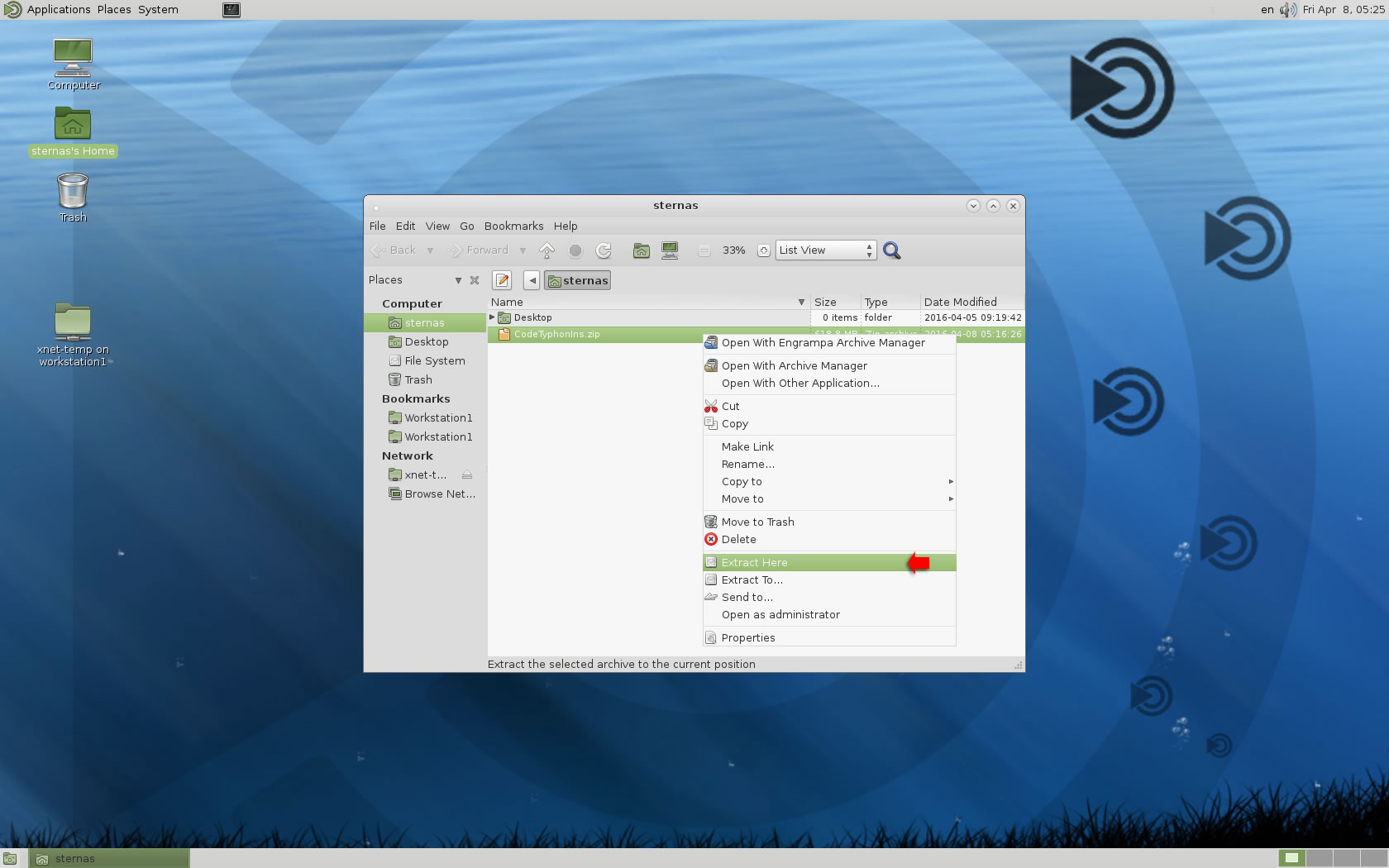

1)-Download CodeTyphonIns.zip

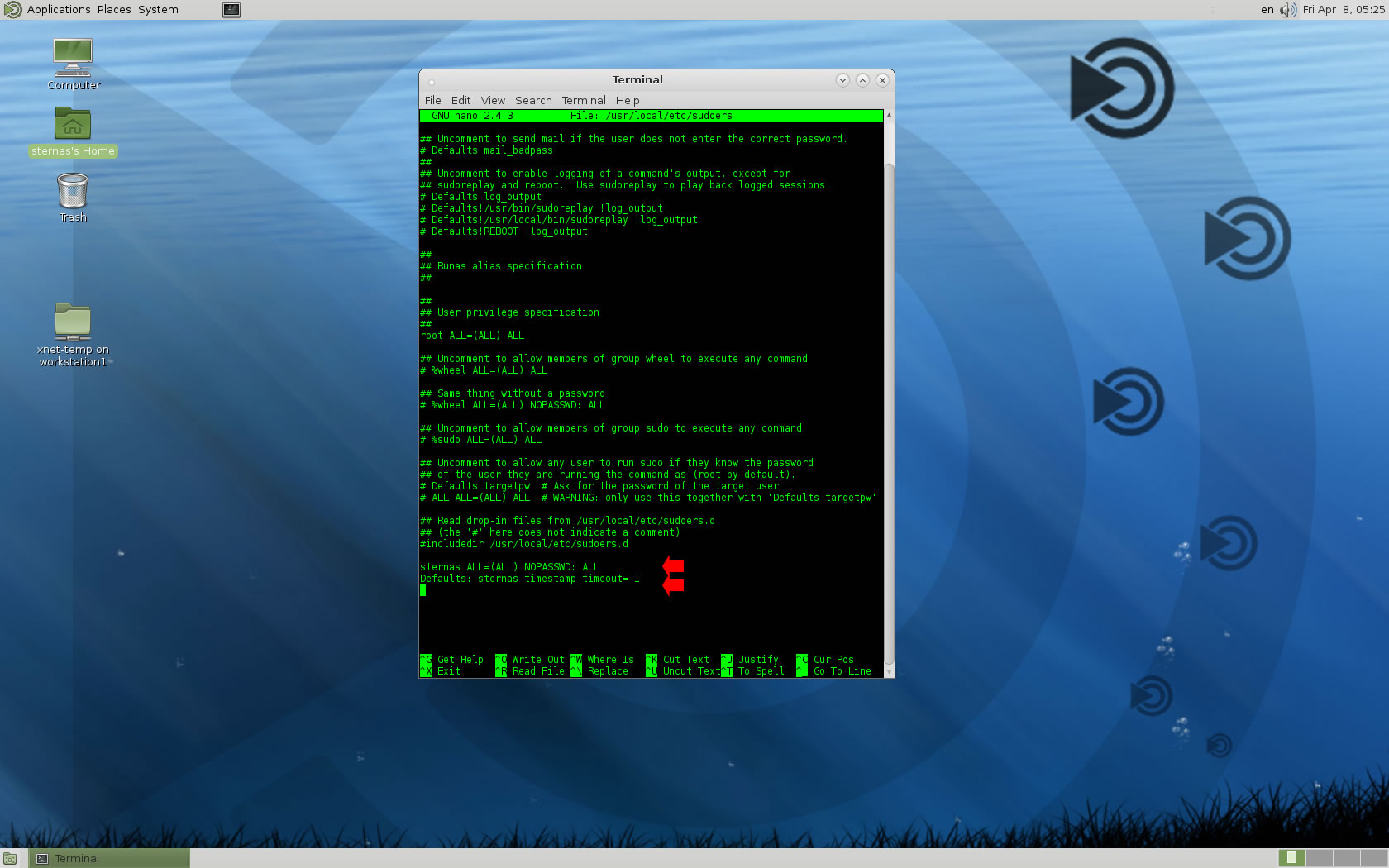

su
nano /usr/local/etc/sudoers
add at the end of /usr/local/etc/sudoers the line
username	ALL=(ALL) NOPASSWD: ALL
Defaults: username timestamp_timeout=-1
3)-UnZip CodeTyphonIns.zip

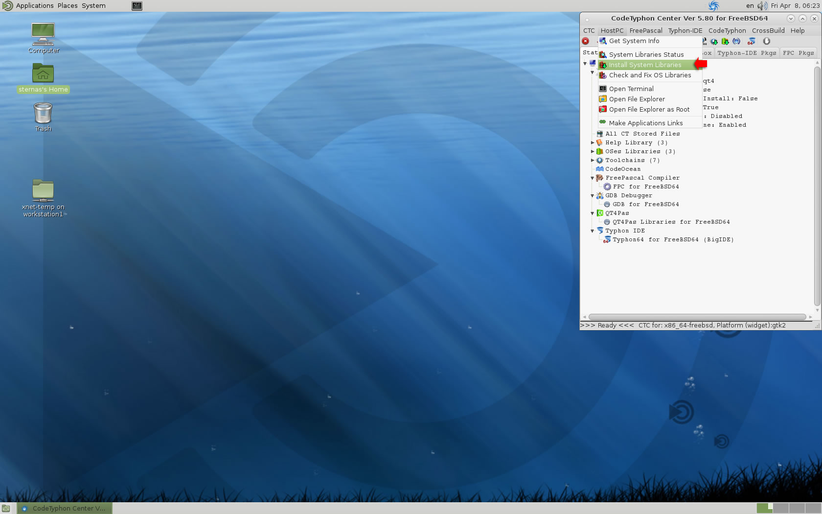

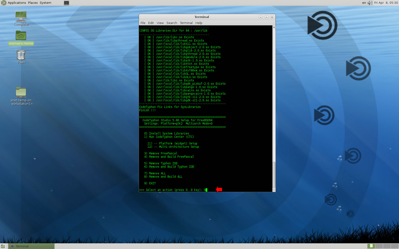

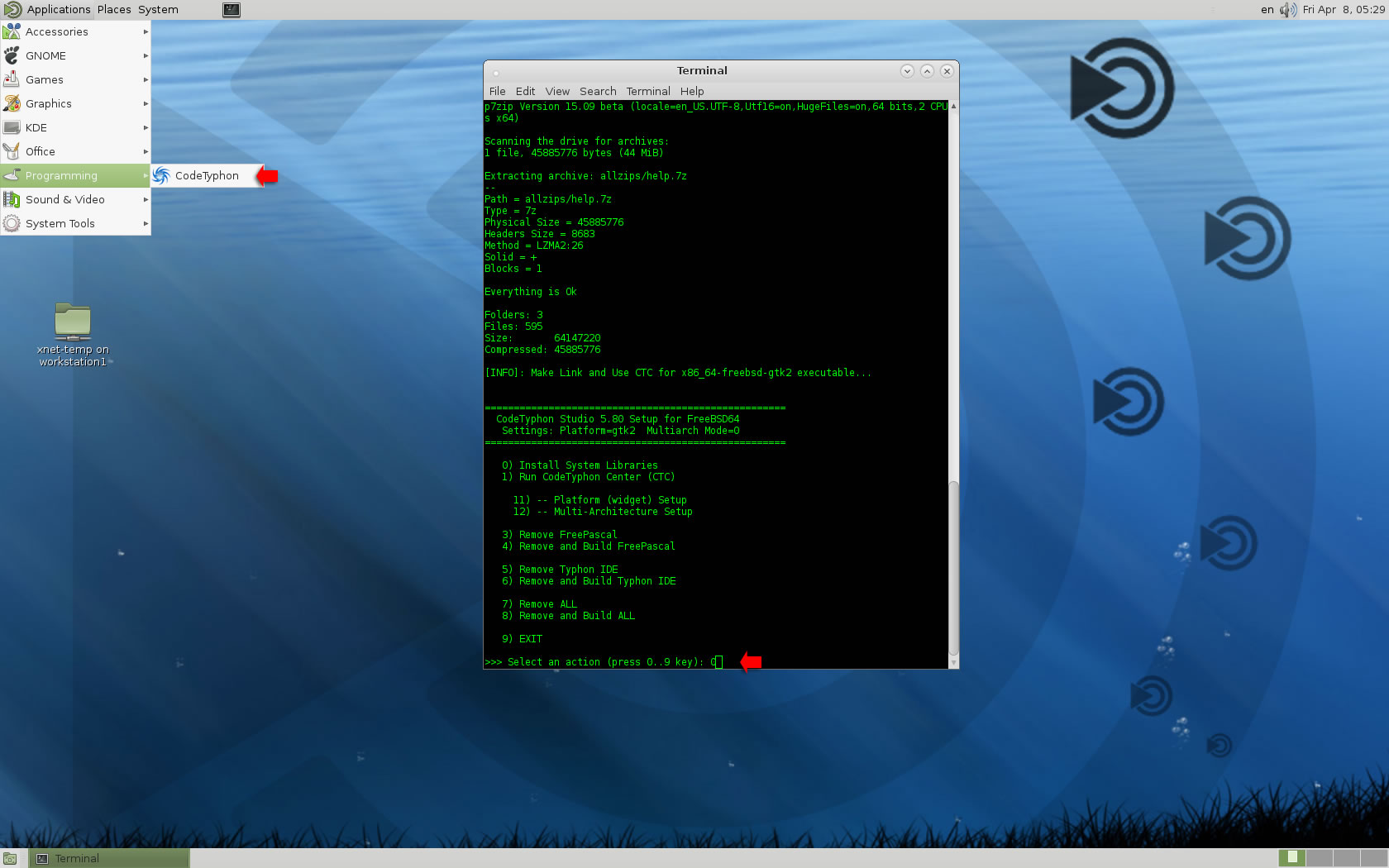

4)-Run install.sh from CT directory to Install CodeTyphon
5)-Install "System Libraries" from CT setup script.

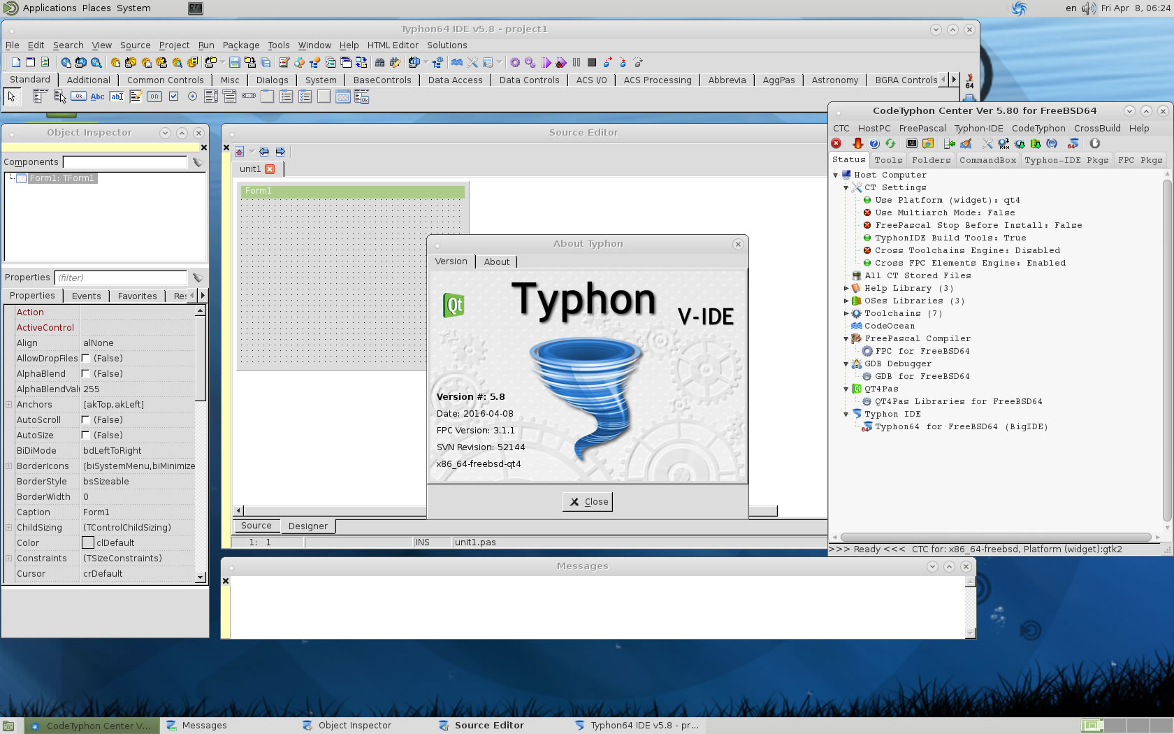

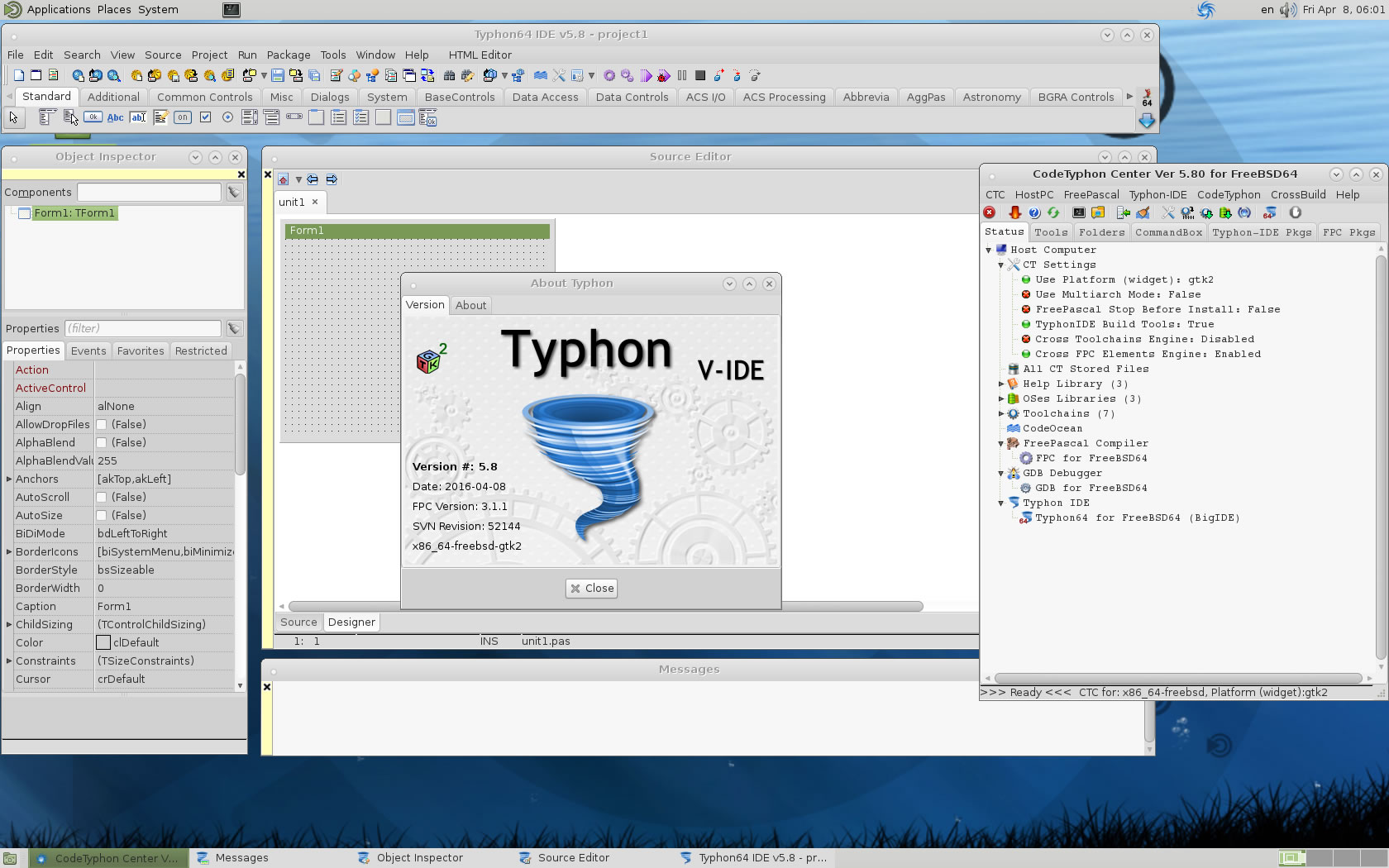

6)-Build ALL (Freepascal and Typhon IDE) from sources

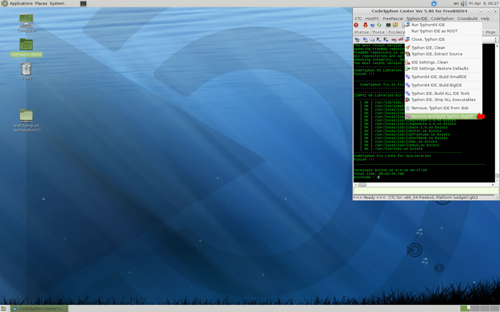

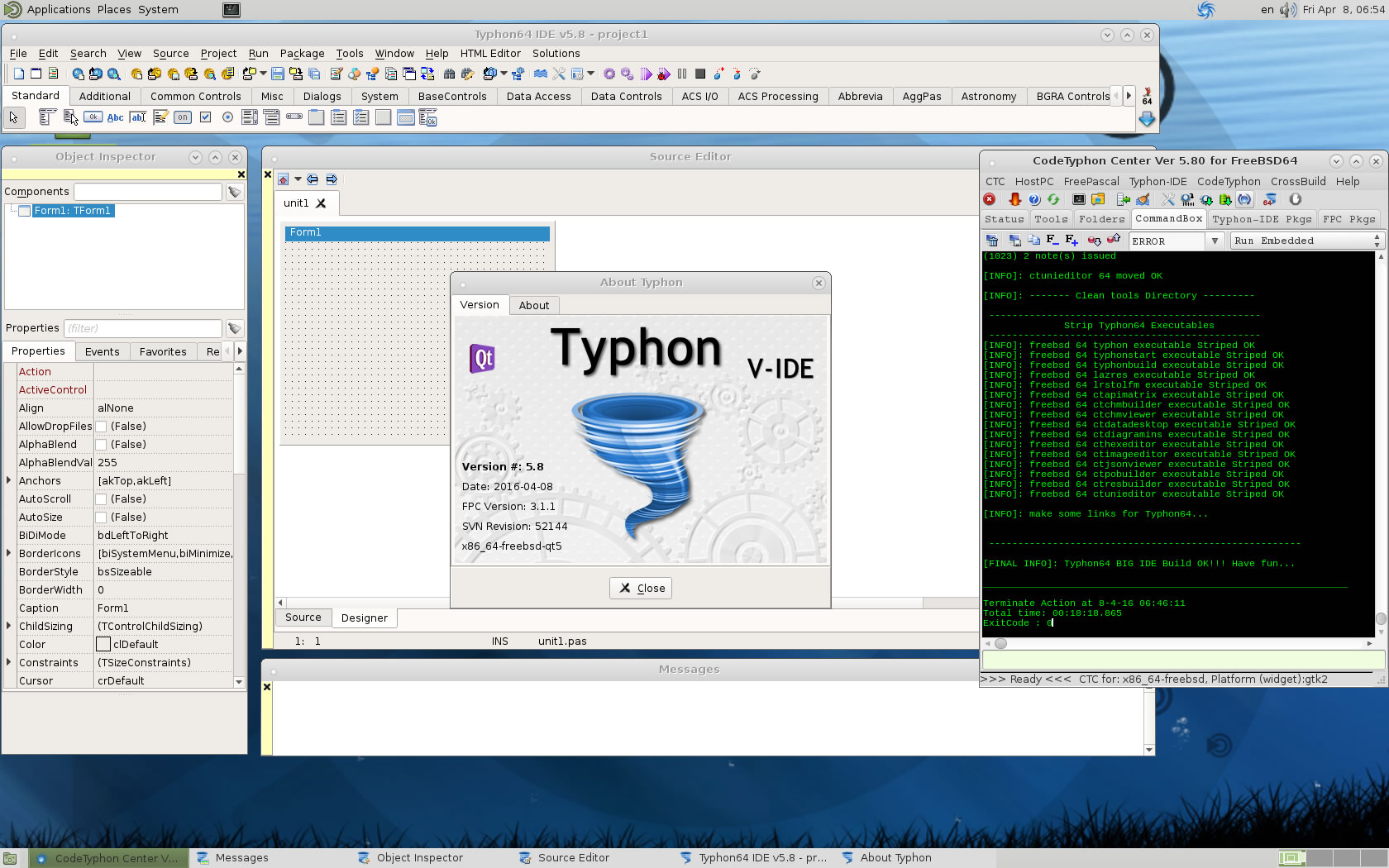

[LAB] CodeTyphon on FreeBSD 10.3 10 years 6 months ago #9423

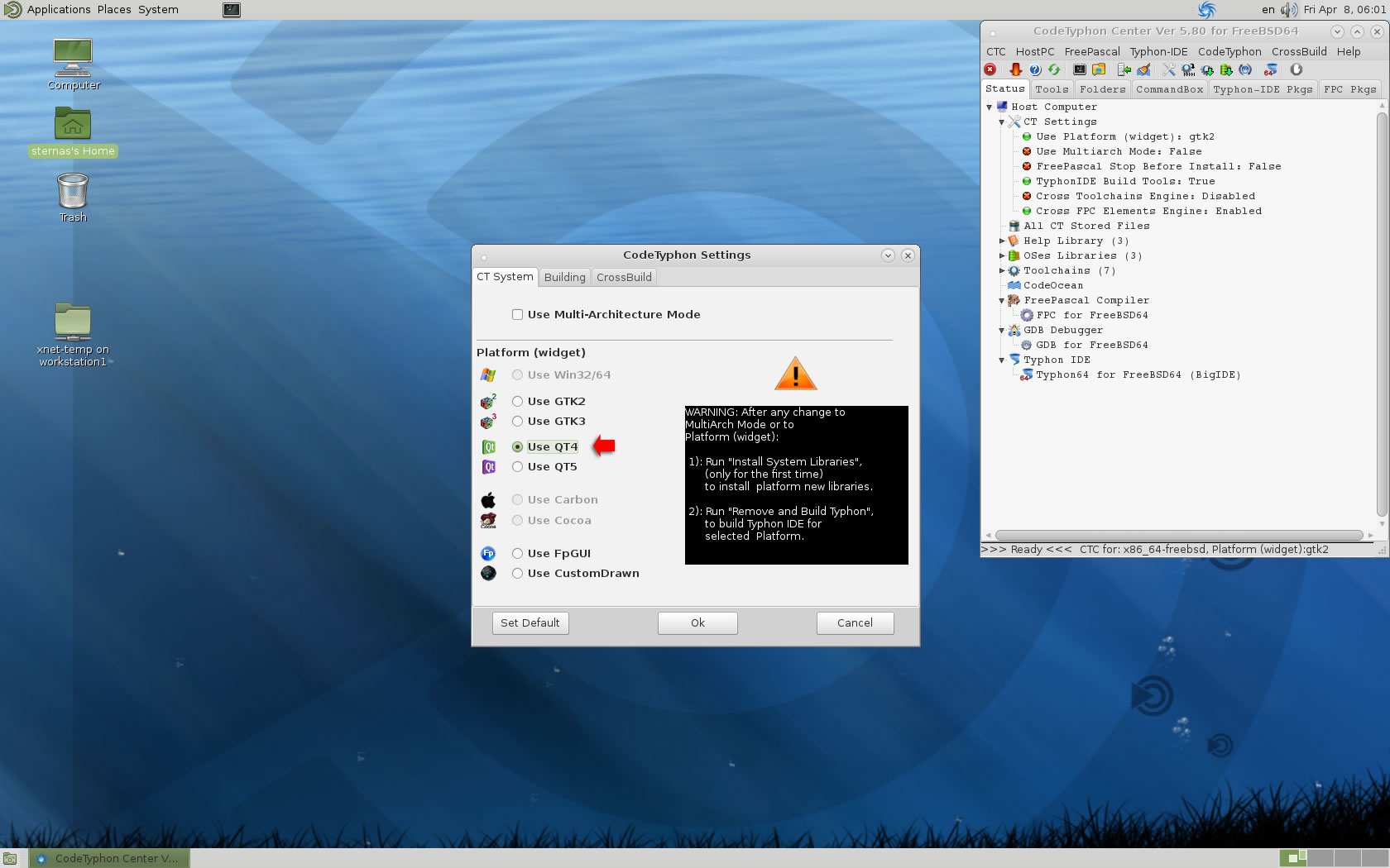

Build Typhon IDE for QT4 procedure:
1)-Open CodeTyphon Center -> Setup Dialog
2)-Set Platform to QT4
3)-Install OS System Libraries
4)-"Remove and Build" Typhon BigIDE

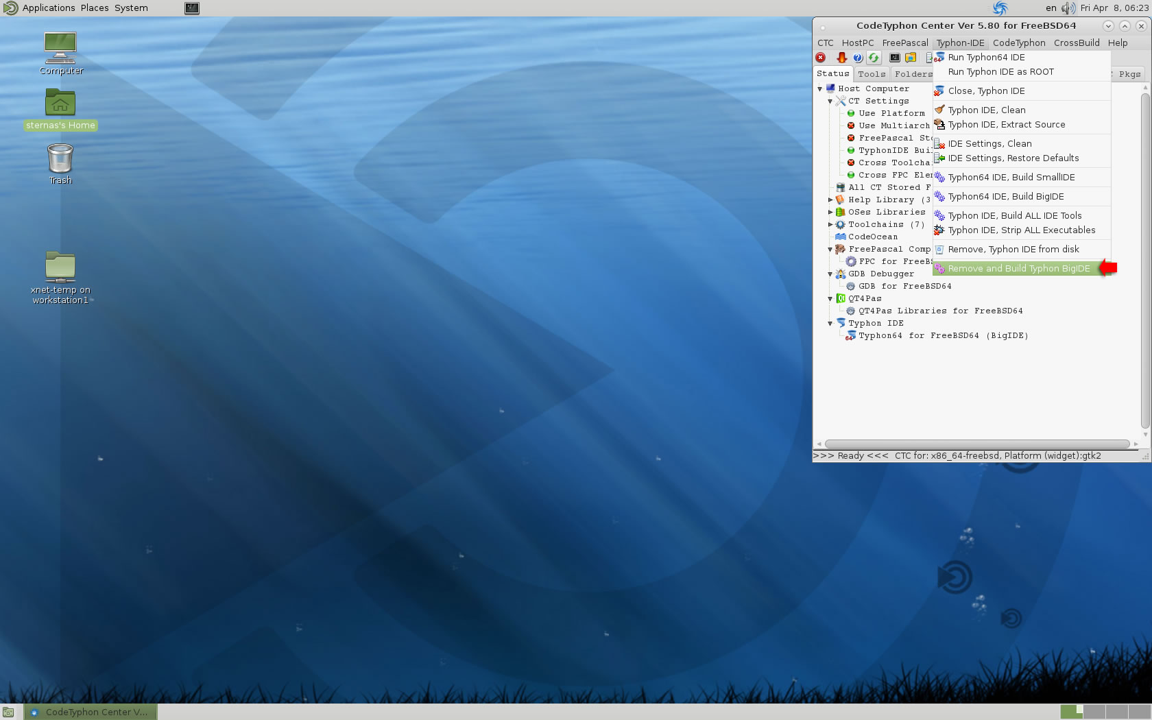

[LAB] CodeTyphon on FreeBSD 10.3 10 years 6 months ago #9424

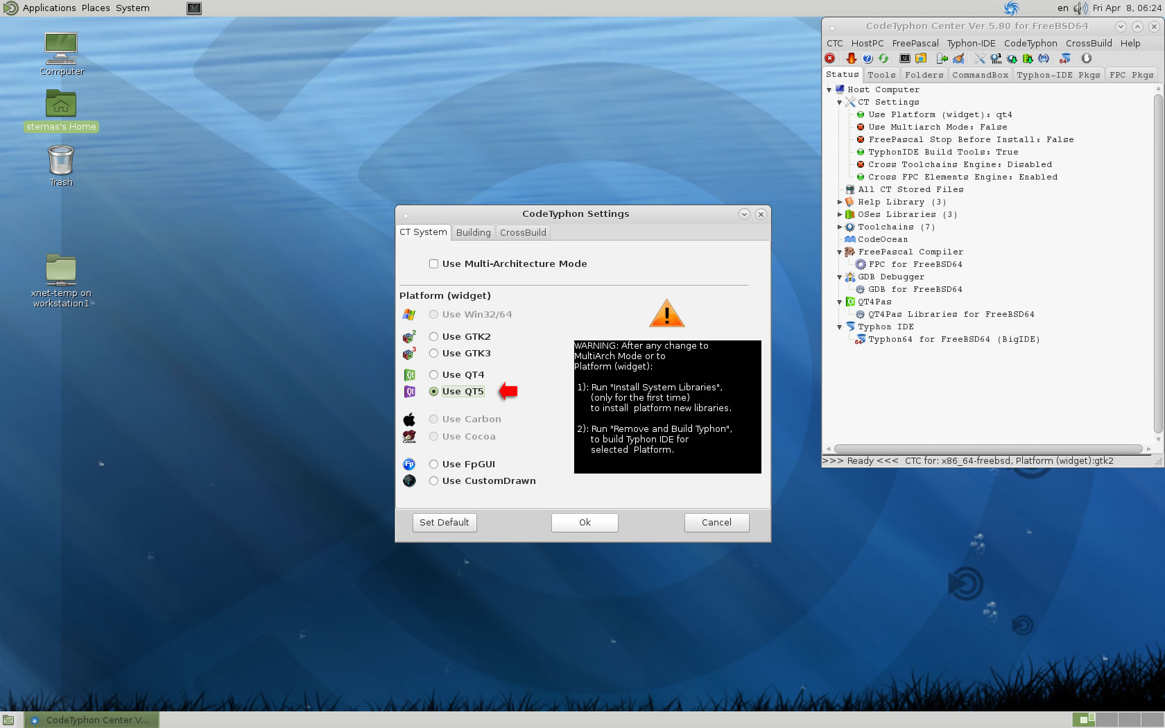

Build Typhon IDE for QT5 procedure:
2)-Set Platform to QT5
