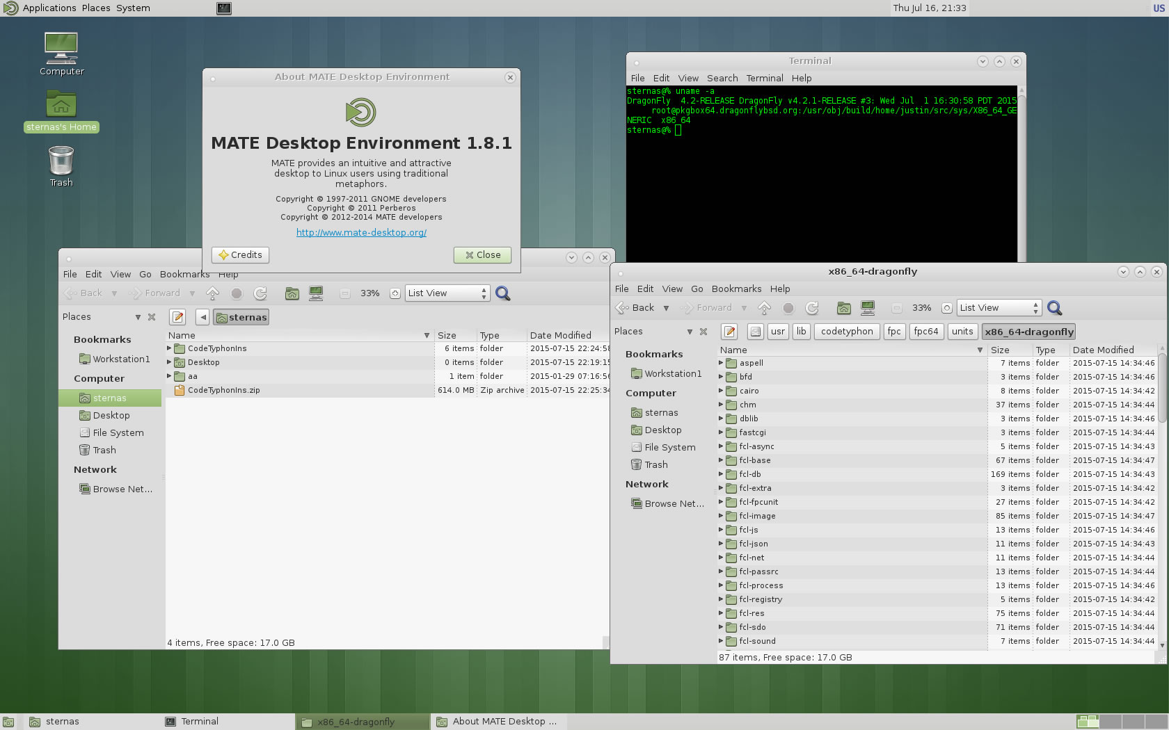

we have ALL BSD in our Lab
FreeBSD32, FreeBSD64, GhostBSD64, PCBSD64, DragonFly64, NetBSD64 and OpenBSD64,
and our LAB truth is: BSD OS architecture DON'T support MultiArch yet.
PS: Our last Lab task is to port CodeTyphon and to DragonFly64. :)
