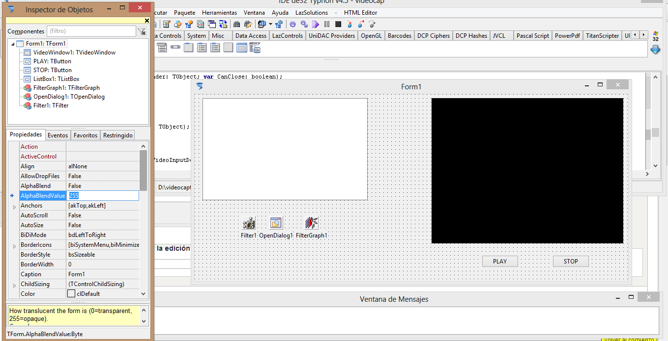

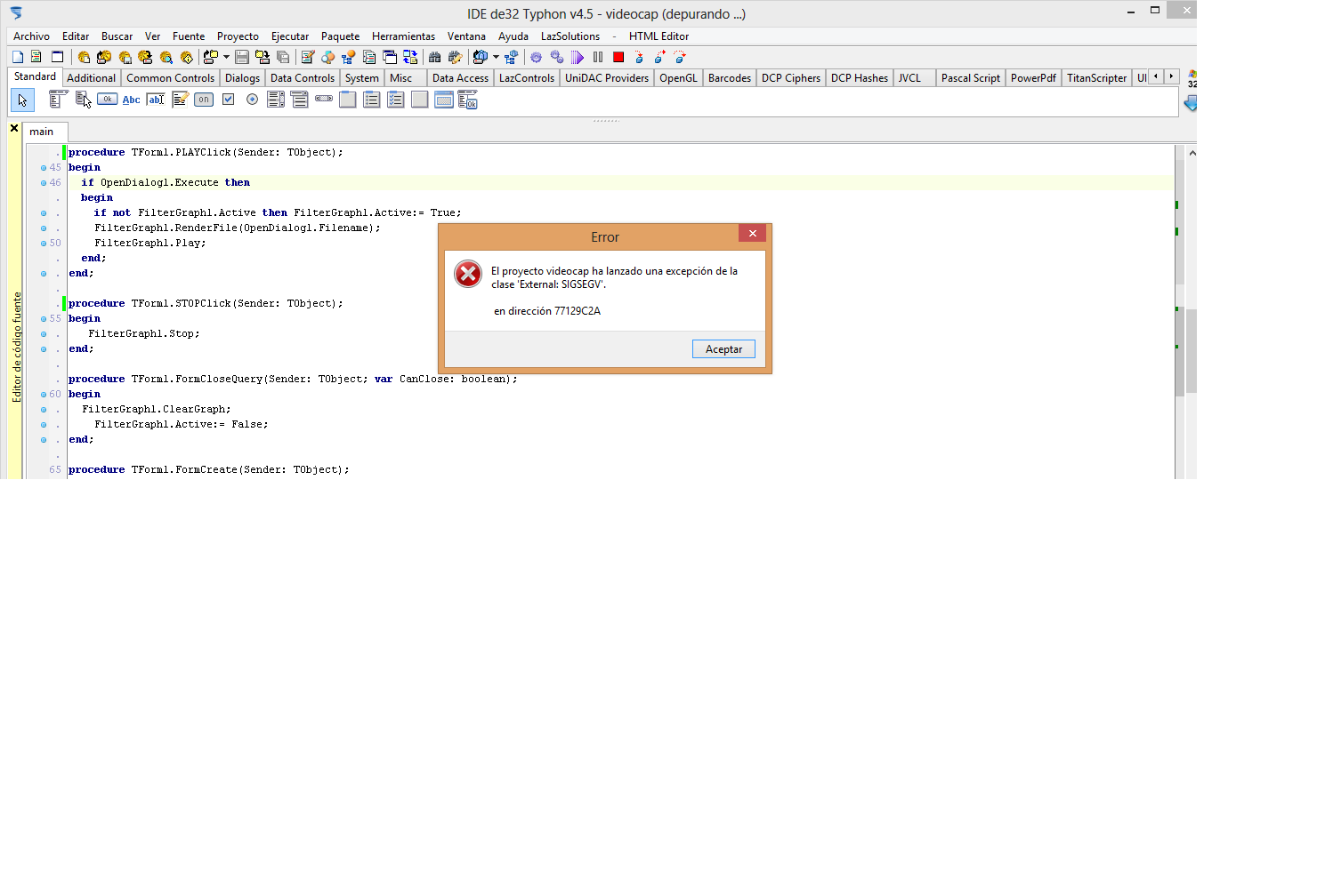

I can not do videocaptura using my webcam. specifically the problem is when you try to activate the component FilterGraph

Have you tried to remove OpenDialog1 from your form and then add it back?
Have you tried to replace "if OpenDialog1.Execute then" with "OpenDialog.Filename:=somefilename;"?
Have you tried to step-by-step execution?

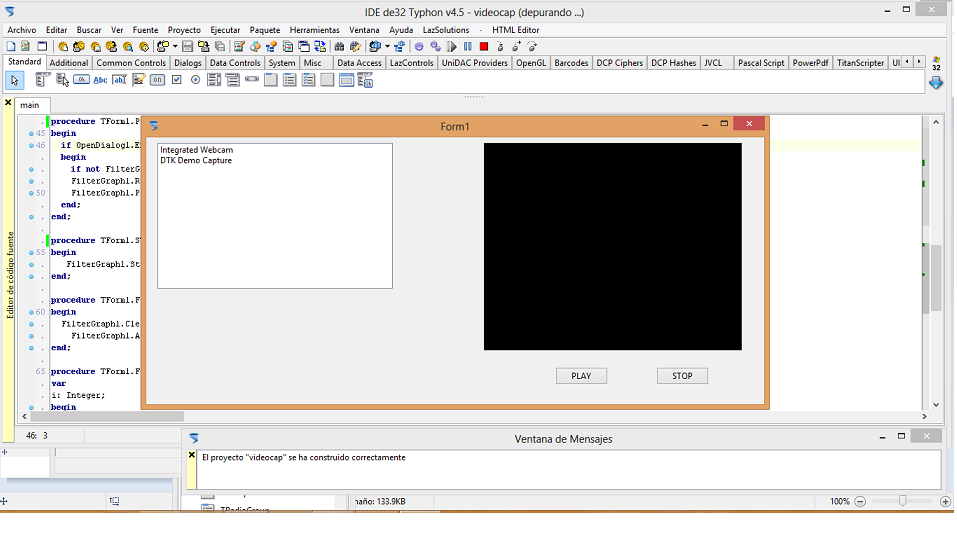

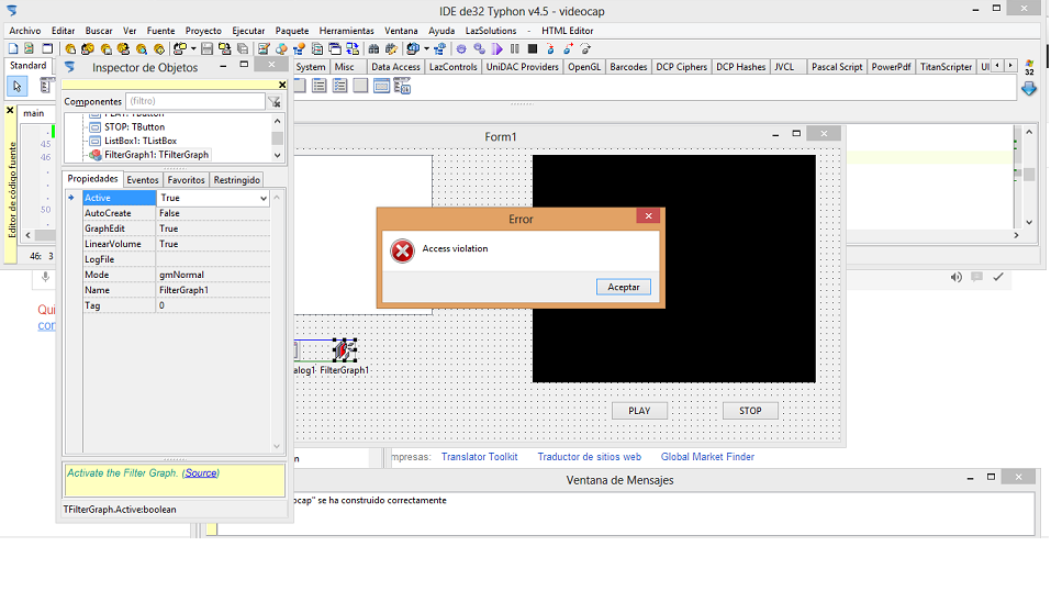

Deputy project:
var
i: Integer;
SysDev:= TSysDevEnum.Create(CLSID_VideoInputDeviceCategory);
if SysDev.CountFilters > 0 then
for i:= 0 to SysDev.CountFilters - 1 do
ListBox1.Items.Add(SysDev.Filters.FriendlyName);
procedure TForm1.ListBox1Click(Sender: TObject);
if FilterGraph1.Active then FilterGraph1.Active:= False;
FilterGraph1.ClearGraph;
if ListBox1.ItemIndex > -1 then
Filter1.BaseFilter.Moniker:= SysDev.GetMoniker(ListBox1.ItemIndex);
FilterGraph1.Active:= True;
FilterGraph1.Mode:= gmCapture;
with FilterGraph1 as ICaptureGraphBuilder2 do
RenderStream(@PIN_CATEGORY_PREVIEW, nil, Filter1 as IBaseFilter,
nil, VideoWindow1 as IBaseFilter);
FilterGraph1.Play;
procedure TForm1.FormCloseQuery(Sender: TObject; var CanClose: boolean);
end
procedure TForm1.STOPClick(Sender: TObject);
FilterGraph1.Stop;
procedure TForm1.PLAYClick(Sender: TObject);
if not FilterGraph1.Active then FilterGraph1.Active:= True;
FilterGraph1.RenderFile(OpenDialog1.Filename);
FilterGraph1.Play;
:ohmy:
THE PROBLEM OCCURS WHEN TO GIVE doubleclick ACIVAR READY FOR MY WEBCAM AND VIDEO CAPTURE

Please use code tag around your code next time in order to make it more readable. Same line of code looks different inside code and text.
One line of code in code tag:
SysDev.Filters[i].FriendlyName;
Same line of code in pure text:
SysDev.Filters.FriendlyName;
Forum render those things differently so it looks like that part of your code is not good, but actually it is. As you can see forum "eats" letter I in brackets, since forum consider that as start of italic text.
Now let's get back to your problem.
Looks like you want to mix capture and play. In that case, you have two approaches. Both are basically very simple, but you have to be careful.
First choice is to use one FilterGraph and two Filters. One for capture and one for playback. You need to stop playback (or capture), then to change FilterGraph mode and to switch Filter that is connected to FilterGraph after that. Then you just need to start FilterGraph again. That's all.
Second approach is to use two FilterGraphs (and two Filters). One pair for capture and one for playback. In this case you also have to stop playback (or capture) but this time you need to switch FilterGraph which is connected to VideoWindow. This is easier approach, since you do not need to change FilterGraph mode each time.
There is also a third approach, that is maybe easiest, but I do not recommend it. You can have separate set of components (Filter, FilterGraph and VideoWindow) for both capture and playback. In this case you just need to stop FilterGraph and to change visibility of VideoWindow, and of course to start FilterGraph again.
Basically you try to accomplish first approach, but you haven't done it completely and properly.

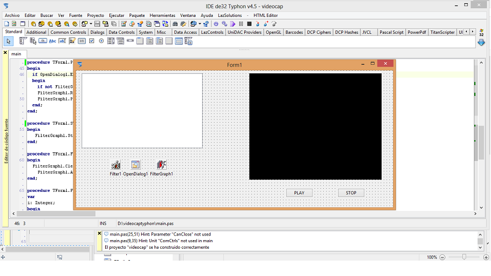

Hello. viking
I appreciate your help. I did what you say and everything worked properly to me ok.
I offer apologies for misspellings but my English is not very good. Always I have to resort to google translator.
thanks again :)
