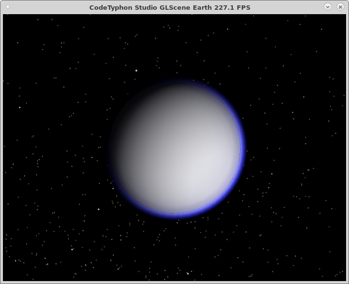

Transferred from chat:
Interesting thing I discovered this week after quite a bit of hair pulling. Under Linux, pl_GLScene will not display textures if the nVidia proprietary drivers are used. However, the textures display correctly under Nouveau. This was tested under Fedora 27 and 30.
The version(s) of CT were 6.8 and 6.9. The 6.8 was under Fedora 27 and 6.9 under Fedora 30. I also verified the behavior under an old Fedora 14 using CT 6.8, but it was 32 bit.
Can anyone else verify the behavior under other Linux environments? I used the Earth demo under the CodeOcean area as a main test, but none of the samples (nor my project's code) will display textures with the nVidia driviers.

Thank you for the data point. Can you say what version of the nVidia drivers you used that worked? Are they the drivers direct from nVidia or from the repositories?
We're also using MATE as the desktop. The widgets are compiled for GTK2 in CT.
The Fedora 30 machine is using an i7, Quadro K1100M, 2GB VRAM, 24GB RAM, CT 6.9
The Fedora 27 machine is using an AMD FX series with 8 cores, GeForce GTX-960, 4GB VRAM, 16GB RAM, CT 6.8.
Attached is an example of what is happening under the nVidia Proprietary drivers on the machines above. Under Nouveau, everything is good.
Since we seem to have removed the distro from the equation, it's down to either the X modes or nVidia driver differences. I've verified that what is attached is happening on nVidia drivers with a wide difference in versions, so it is not an issue with just a single nVidia driver revision.
Also, wayland is disabled on these machines, so that has to be considered as a variable.
