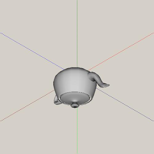

The printed image gives me a mirrored image of the scene. Does anyone know this problem and have a solution for it?

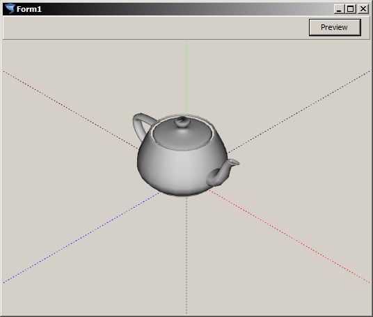

Attached the printed image (test.jpg) and a screenshot form my application.
This is the code I use:

I created a very simple GLScene sample project using a GLViewer and a GLMemViewer. Added a dummycube, with a teapot as childobject, a GLCamera and a GLLightsource. Furthermore I added the printing stuff (same as above) with a TImage in a second form. It produces the same results. See the attached files with a screenshot of the app. and a rendered image which was saved to disk.

I tried running a modified sample on both Delphi and CT (attached). The Delphi version was fine making a test output while the CT version gives up-side-down image. So, it looks like it's related to the CT conversion of GLScene. I'm still new to CT and sorry that I can't help further.
