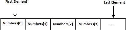

Instead of declaring individual variables, such as number1, number2, ..., and number100, you declare one array variable such as numbers and use numbers[1], numbers[2], and ..., numbers[100] to represent individual variables. A specific element in an array is accessed by an index.
All arrays consist of contiguous memory locations. The lowest address corresponds to the first element and the highest address to the last element.
Please note that if you want a C style array starting from index 0, you just need to start the index from 0, instead of 1.
