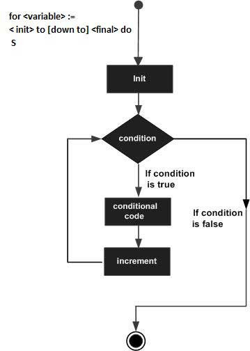

Here is the flow of control in a for-do loop:
- The initial step is executed first, and only once. This step allows you to declare and initialize any loop control variables.
- Next, the condition is evaluated. If it is true, the body of the loop is executed. If it is false, the body of the loop does not execute and flow of control jumps to the next statement just after the for-do loop.
- After the body of the for-do loop executes, the value of the variable is either increased or decreased.
- The condition is now evaluated again. If it is true, the loop executes and the process repeats itself (body of loop, then increment step, and then again condition). After the condition becomes false, the for-do loop terminates.
2. Flow Diagram
3. Example:
