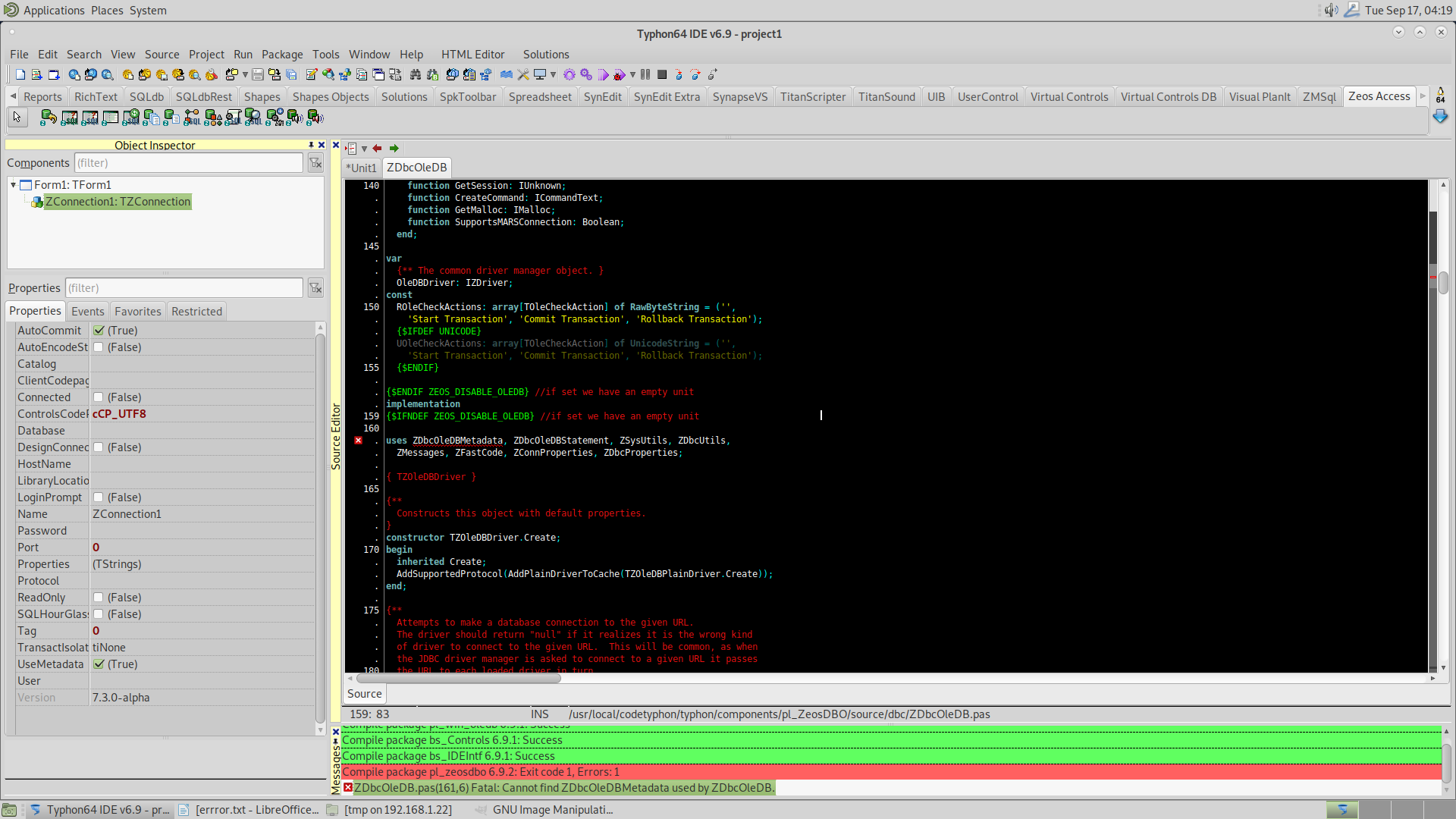

I've a problem when compile on Typhon 6.9 r61812 FPC 3.3.1 r42912 Platform : x86_64-linux-gtk2 Debian 10 On VirtualBox 4GB
my target is Win64 bit arch x86_64
if I build a blank form program that's ok, but if insert Zeos component I receive this error:
but,
cross build for raspberry pi3b ok and for Linux 64bit gtk2 ok.
Thanks in advance.

ZEOS *Ole*.pas files are only for MS Windows and
NOT build with MultiCPU-MultiOS pl_ZeosDBO package.
Just ADD into your App the Zeos *Ole*.pas files you want to use from
codetyphon\typhon\components\pl_ZeosDBO\source\
folder

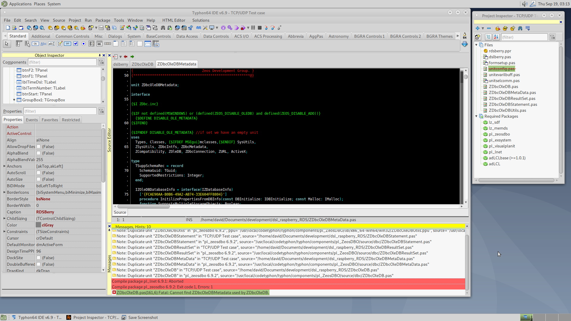

I found ZDbcOleDBMetadata.pas (and other file *Ole*.pas) and I copied into directory project but don't work, I add directory "/usr/local/codetyphon/typhon/components/pl_ZeosDBO/source/dbc/" into Paths of Project option but don't works....
What I wrong?

Did you add *Ole*.pas files in to your project file ?

Matis, I Add file into directory project, and I try to set up Project / Option / Compiler Option / Other Sources but the files * Ole * .pas that I copied into my directory are not selectable (the files permission was setted ok)
can you explain me which is the correct way?

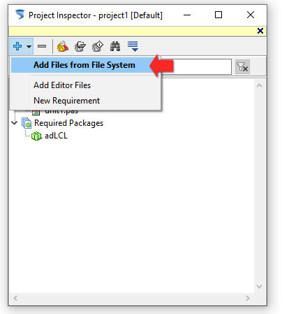

open Project Inspector
and ADD the files files * Ole * .pas you want

I Receive the same error

Please rename to unit ZDbcOleDB line 161
uses ZDbcOleDBMetadata, ZDbcOleDBStatement, ZSysUtils, ZDbcUtils,
with
uses ZDbcOleDBMetaData, ZDbcOleDBStatement, ZSysUtils, ZDbcUtils,
It's Unix and it's ZDbcOleDBMetaData.pas file name
On Windows this is NOT a Problem.
ZEOS it's NOT develop for CrossBuild from Linux to Windows
