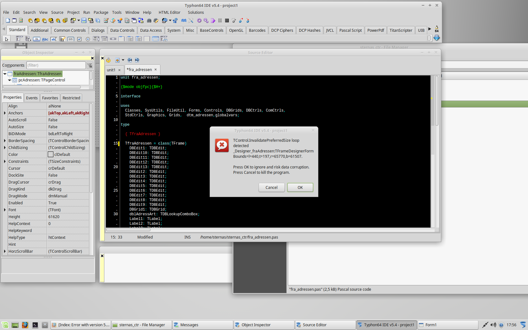

- maybe some packages not linked in IDE
- some problems of resizing components during display in the IDE
it seems it is related to the modifications in Embedded Designer/Glassdocking.
On my config (Typhon32 Win 8.1 64bit docked windows without Embedded Designer), it crashes.
TControl.InvalidatePreferredSize loop detected _Designer_fraAdressen:TFrameDesignerForm Bounds=l=440,t=197,r=65770,b=61507.
(Same as on the screenshots of Sternas, ok with Embedded, crashing without)
[A problem between Integer and PtrInt somewhere maybe ?]
This error comes from c:\codetyphon\typhon\lcl\include\control.inc, in procedure TControl.InvalidatePreferredSize;

To avoid this:

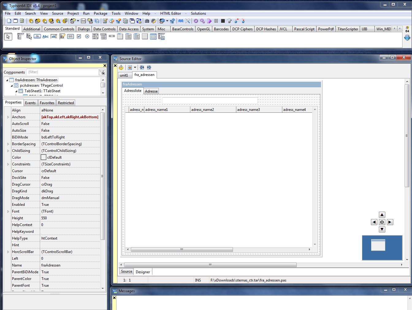

I started Typhon normally and reactivate Embedded Designer.
Then I restarted Typhon to take account of the change, loading the project, now F12 displays correctly the form.
Obviously it is a problem of resizing of the frame.
I set back my IDE for Embedded Designer and restarted it.
Ok with F12, it appears -> Need to be in Embedded Designer
