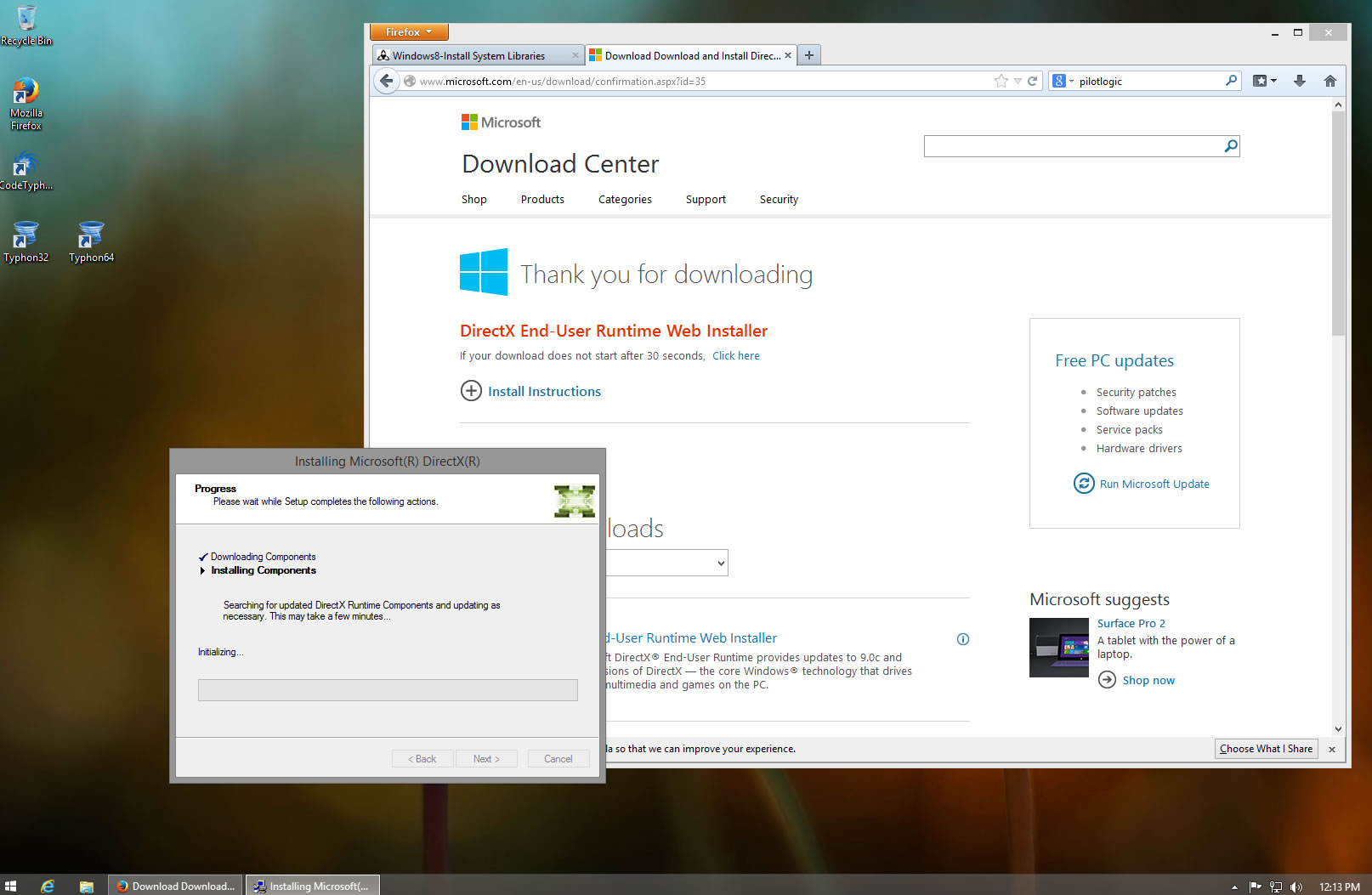

If you try to run web installer from www.microsoft.com/download/en/details.aspx?id=35 on Windows 8.1, it will fail with message like "An internal system error has occurred" and a reference to check DXError and DirectX log files.
I installed 8.1 x64 in new VM last night, update it and then started web installer. I almost always use offline installer so I never before experienced what I just described.
There are more posts about this problem on the net, like this one for example: forums.majorgeeks.com/showthread.php?t=264612
I think it might be good to remove web installer link from wiki for Windows 8.

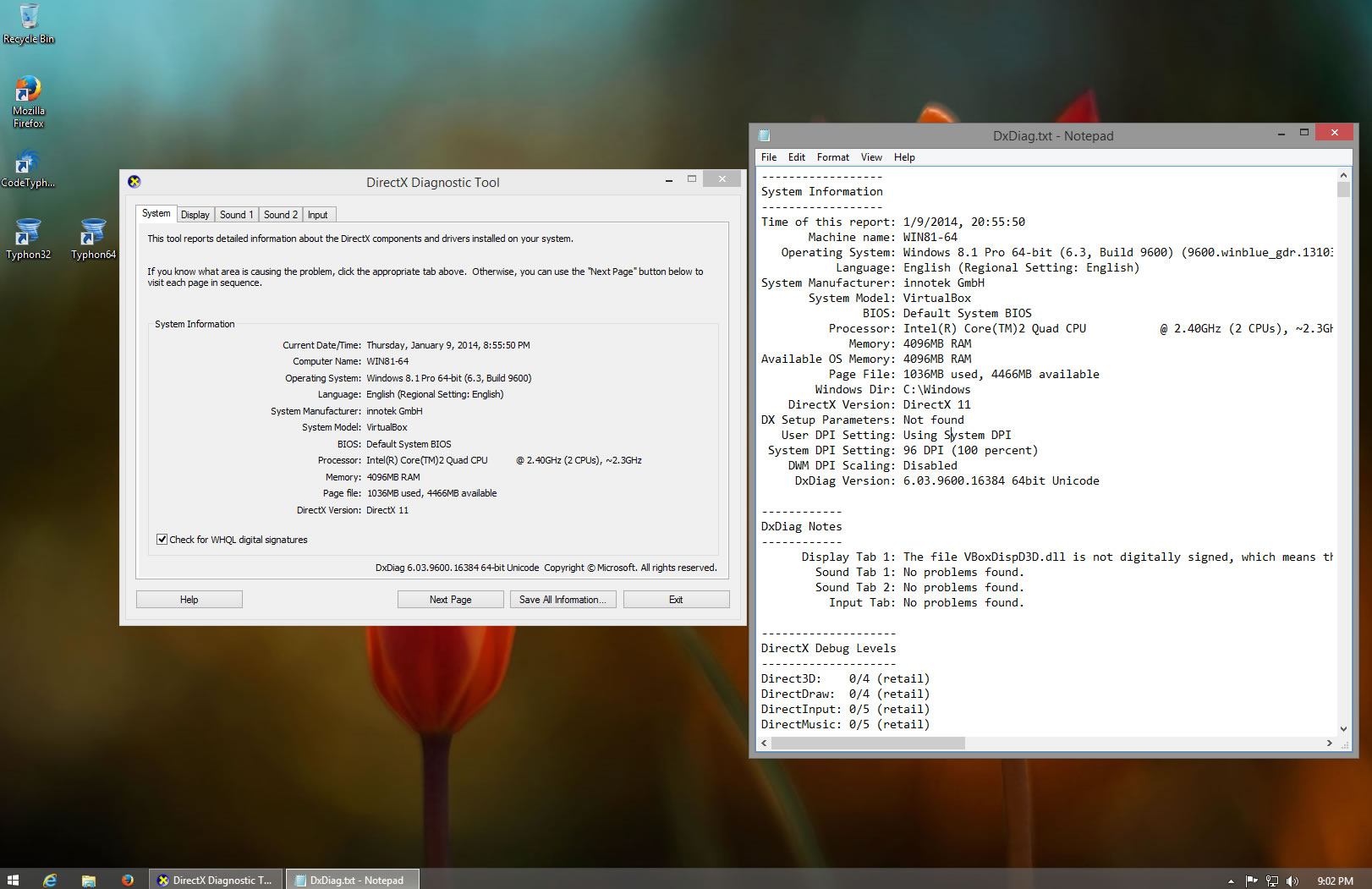

If you click on Save All Information in DXDiag you will get more detail info about your OS then it is displayed on DXDiag page itself.
System info from DXDiag
System Information
Time of this report: 1/10/2014, 01:24:12
   Operating System: Windows 8.1 Pro 64-bit (6.3, Build 9600) (9600.winblue_gdr.131030-1505)
    DirectX Version: DirectX 11
DX Setup Parameters: Not found
     DxDiag Version: 6.03.9600.16384 64bit Unicode
What you have? :huh:

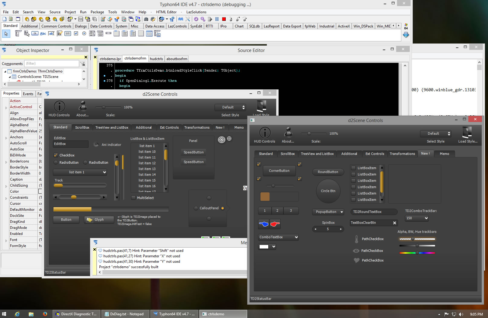

and a test of pl_ORCA on 64bit (new!!!)
System Libraries for Windows 8 11 years 3 months ago #5000
  • Miquel Matas
  • Miquel Matas's Avatar
  • Posts: 121
  • Thank you received: 10
I'm glad to see ORCA running in 64bits!
Waiting for next release?
Soon?
