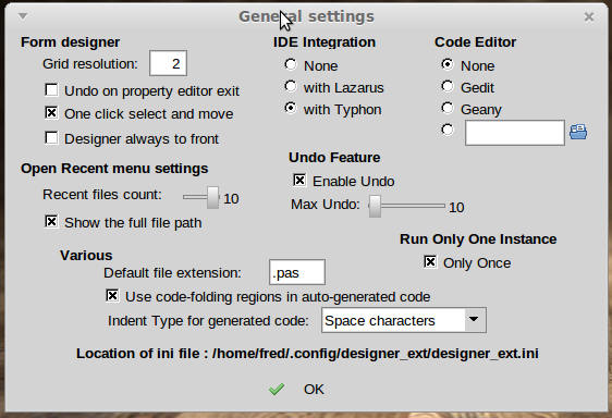

Hello :)
I tried to integrate fpGui and uidesigner into codetyphon as described in the readme file readme_patch_typhon.txt.
But, in uidesigner_ext settings integration for "lazarus" and "codetyphon" is always disabled.
What's wrong? Can you help me please?
Hum, i do not understand...
In designer_ext, there is "settings" menu. When you click on it, there is a window with => Integration into IDE =>
. None
. Into Lazarus
. Into Typhon => click on it.
See first topic of "Patch for fpGUI integration..." for explaination how to install all.
PS : Typhon or Lazarus must be installed.
What os are you using (Linux, Windows,...) and where have you installed Typhon (C:\, /user/.. ?)
Fred

What is the directory of designer_ext ( c:\designer_ext\ ? )
Could you please run designer_ext.exe as standalone, then click on => Settings => General settings.
On bottom of setting-form, what do you get ? =>
Location of ini file : c:\users\... ?

@ Wosc => Indeed, you are right, for Windows it was a problem...
I apologize. It was because Windows use different config-directory with each new Windows version.
It is fixed in new release.
May you try with committed version ? (there are already compiled designer_ext in /bin/widows)=> github.com/fredvs/uidesigner_ext
PS You do not need to re-apply the Typhon patch, it was a designer_ext problem.
PS2 I hope that Sternas will integrate fpGUI designer in real, so that "virtual" integration will become "true" integration.
Many thanks to note it.
Fre;D

Directory of uidesigner_ext is c:\lib\fpc\uidesigner_ext.
If I compile(as described) then the new EXE is in c:\lib\fpc\uidesigner_ext\src\uidesigner_ext.exe
The Path in General Settings is: c:\Users\ws\AppData\Local\designer_ext\designer_ext.ini
Patch for fpGUI integration... 11 years 11 months ago #6317
  • Fred
  • Fred's Avatar Topic Author
Hello. Yes, it was what i guess, Windows 7 uses a different config-path than XP.
It is fixed in new designer_ext release. (see my last topic, just before your last one).

Now the settings dialog in designer_ext work.
That are already good news :)
Do you have checked Integration into Typhon and closed designer_ext after that ?
Please, do not try to load files of designer_ext project => It could cause conflict with designer_ext loaded by Typhon.
Normally, if you load from "open file" in Typhon a fpGUI-form-file, Typhon must load fpGUI-form-file in his source-editor and also load designer_ext with that file.
Hum, give me some minutes and i will do a screen-recording of what must append.
Fre;D
