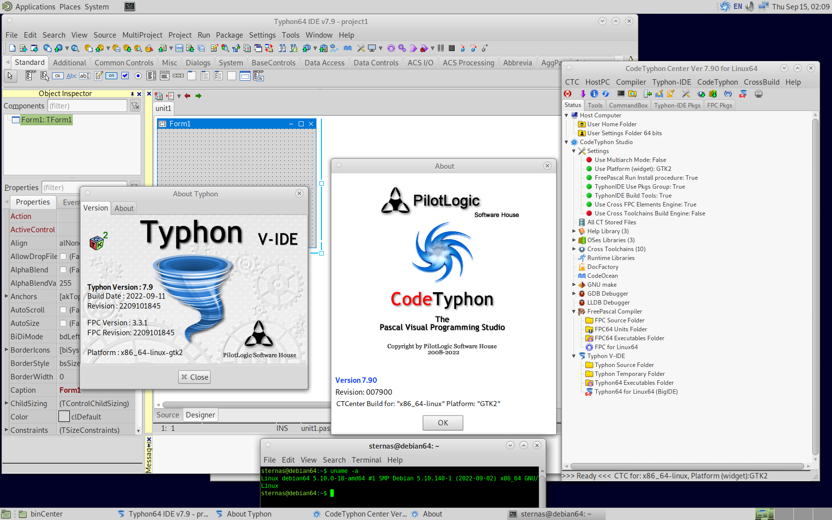

Checked CT ver 7.9 on Debian 11 (installed from CodeTyphonIns.zip), the environment works reliably,
checked projects (gtk2, pl_rx, fpspreadsheet, sqldb, lz_Report) - everything is ok.
It's a pity that CTCenter does not start (problem with glibc).
Similarly checked in xubuntu 2022.04 virtual machine. Found no problems, well, CTCenter works on this machine.
Best regards

CT LAB ver 7.90 4 years 1 month ago #17293
  • Leonid
  • Leonid's Avatar
  • Posts: 54
  • Thank you received: 4
Thank you for your help! Now you can fully work!

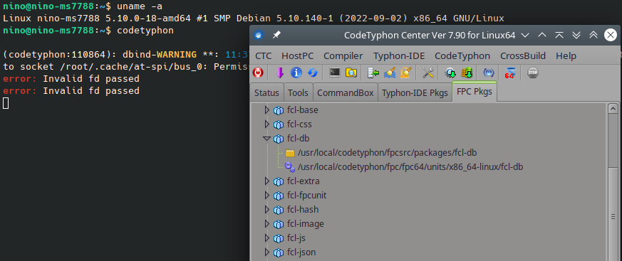

Thank you for the special CT Center build for old Debian 11.
No big deal but trying to open a file system link from CT Center does not work and results in 'invalid fd passed' error.
Same error when using CT Center from version 7.70
Attached screenshot refers.
Links work as expected on my Raspberry Pi 3 running 32 bit Raspberry Pi OS
