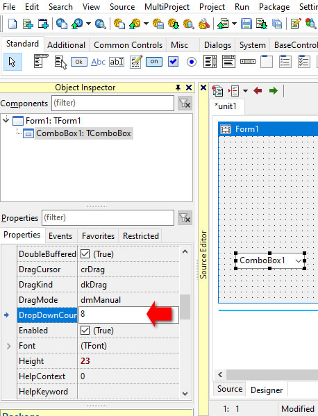

Setting "Drop Down Count" for Comboboxes  in general options doesn't work since few versions.

Example:
I have set "drop down count" in general options to 25.
I put combobox on form, but it's value in properties > dropdowncount is 8 instead 25.
CT LAB ver 7.50 5 years 4 months ago #15929
  • Posts: 1435
  • Thank you received: 231
"drop down count" in general options is only for TyphonIDE Settings
NOT for projects
CT LAB ver 7.50 5 years 4 months ago #15933
  • skrzat
  • skrzat's Avatar
  • Posts: 44
Is it possible to set default value for projects?
CT LAB ver 7.50 5 years 4 months ago #15934
  • Posts: 1435
You must set "visually" the "DropDownCount" property of TComboBox
or
onCreate of TComboBox parent form with code
  ComboBox1.DropDownCount:=30;
or
to create your TComboBox class, with code to handle the DropDownCount property as you want.
CT LAB ver 7.50 5 years 4 months ago #15936
  • skrzat
  • skrzat's Avatar
  • Posts: 44
I know both solutions, but I want to set default value (save in .frm file) to avoid setting it for every new combobox.
