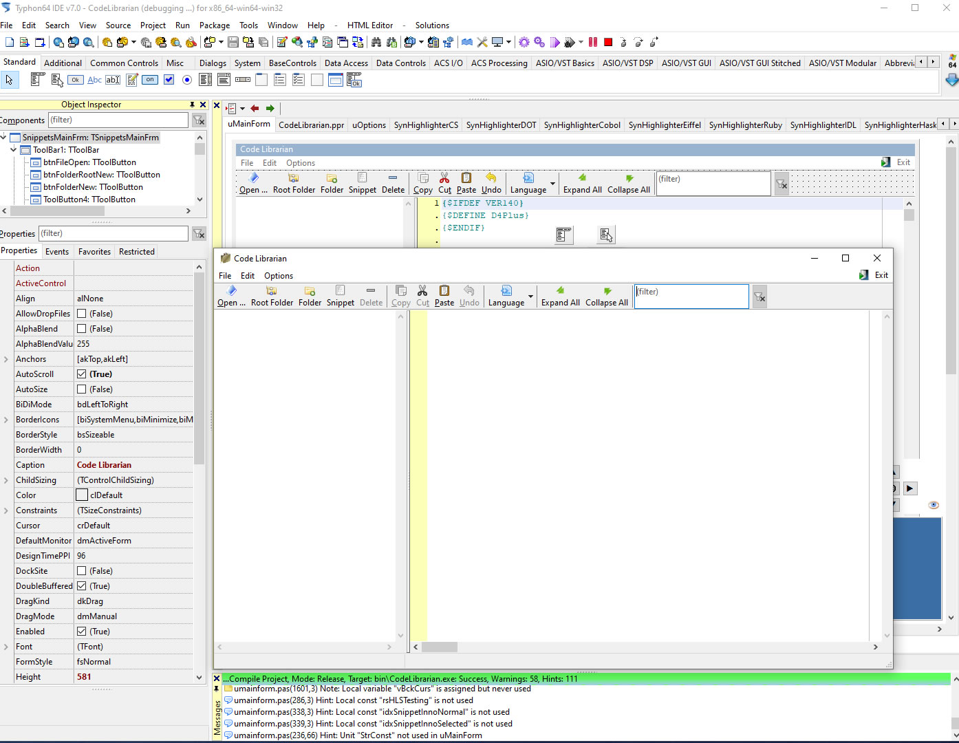

Sir we fix this Laz 1.4 Project ???? :woohoo:
Download the new source from here
The Source from GIT has many, many, many, problems
umainform.lfm
object SnippetsMainFrm: TSnippetsMainFrm
<<<<<<< HEAD
  Left = 315
  Height = 581
  Top = 56
  Left = 352
  Height = 581
  Top = 100
>>>>>>> 747aae165a283c89228d908bb5cbe9c7cd942bda
  Width = 987
  HorzScrollBar.Page = 824
  VertScrollBar.Page = 160
  AutoScroll = True
  Caption = 'Code Librarian'
  ClientHeight = 561
  ClientWidth = 987
  Menu = mnuMain
  OnClose = FormClose
<<<<<<< HEAD
  LCLVersion = '1.4.4.0'
  LCLVersion = '1.4.0.4'
CodeLibrarian.lps
<?xml version="1.0" encoding="UTF-8"?>
<CONFIG>
  <ProjectSession>
    <PathDelim Value="\"/>
    <Version Value="9"/>
    <BuildModes Active="Debug"/>
<<<<<<< HEAD
    <Units Count="12">
      <Unit0>
        <Filename Value="CodeLibrarian.lpr"/>
        <IsPartOfProject Value="True"/>
        <EditorIndex Value="-1"/>
        <CursorPos Y="16"/>
        <UsageCount Value="237"/>
    <Units Count="13">
      <Unit0>
        <EditorIndex Value="3"/>
        <CursorPos Y="16"/>
        <Loaded Value="True"/>
      </Unit0>
      <Unit1>
        <Filename Value="umainform.pas"/>
        <ComponentName Value="SnippetsMainFrm"/>
        <HasResources Value="True"/>
        <ResourceBaseClass Value="Form"/>
        <UnitName Value="uMainForm"/>
        <IsVisibleTab Value="True"/>
<<<<<<< HEAD
umainform.pas
Line 1644
        vToLib.CreateFolder(vNewFolder);
<<<<<<< HEAD
        CopyAttributes(vNewFolder, InclPathDel(aSourceFolder) + vFolders[vCnt]);
        CopyAttributes(vNewFolder, vNewFolder);
        ImportFolder(aSourceFolder + vFolders[vCnt] +cDelim, vNewFolder);
Line 1679
<<<<<<< HEAD
    if vToLib.FolderExists(aRootFolder) then //need to change this bhavior the root folder will act only as a host it makes no sense to have a non existing host.
      raise Exception.CreateFmt('Folder %S already exists in the library',[aRootFolder]);
    ImportFolder('/', aRootFolder);
    LoadCodeLib;
  finally
We put fixes (cr9999) to many HighLighters
fRange := TRangeState(PtrInt(Value));  //=== cr9999 ====
Result := Pointer(PtrInt(fRange));    //=== cr9999 ====
My suggestion, if you going to work on this project
look and in lz_SynEditExtra CodeTyphon Package
A screen from Typhon64 on Win10 64

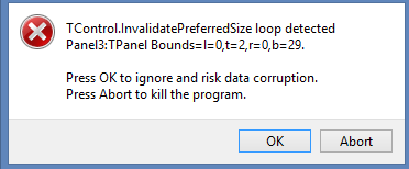

Hello
If I click twice the 'minimize' button (see pic 'Docked_Components_Window.png') of the docked IDE window 'Components' the following error
is issued (see pic 'Docked_Components_Window_show_error.png'). This error occurs with Typhon32 and Typhon64.
Env.: Typhon 7.0 r62372 FPC 3.3.1 r43670 Platform : i386-win32-win32/win64
Thank you for your support
Daniel

CT LAB ver 7.00 6 years 5 months ago #14242
  • Daniel Jaeger
  • Daniel Jaeger's Avatar
  • Posts: 28
Interestingly, this only happens with the 'Components' window, all other Windows of the IDE don't seem to have the problem.
CT LAB ver 7.00 6 years 5 months ago #14243
  • Posts: 4625
  • Thank you received: 1132
Yes I know that,
we must rewrite some functions/procedures in 'Components' window (ct_componentlist.pas)
But we will try to solve this problem after the
Final Release of CodeTyphon ver 7.0
ETA=1 day, if ALL are OK
CT LAB ver 7.00 6 years 5 months ago #14246
  • Posts: 4625
Daniel Jaeger wrote: Interestingly, this only happens with the 'Components' window, all other Windows of the IDE don't seem to have the problem.
Sir, finally we fix and this problem.
