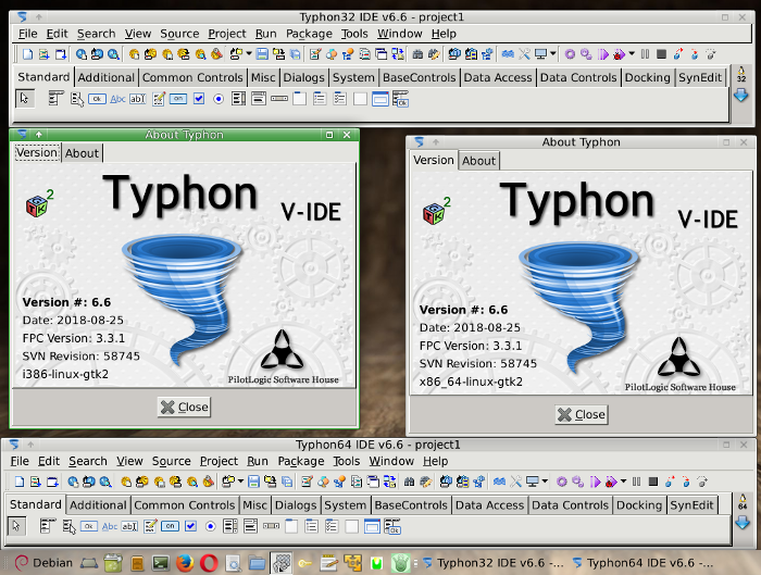

@ Klaus : So, excellent news, they finally fix the bug. ;)
@ Sternas: Indeed Debian 9 is great:
- Compilation + run of Typhon/GTK2 32 + 64 bit is ok and out-of-the-box.
(and so all the blabla of Manjaro+Mint gurus was wrong).
[EDIT: Picture after last CT upgrade.]
Fre;D
Last edit: by fredvs.

CT LAB ver 6.60 8 years 2 months ago #11966
  • fredvs
  • fredvs's Avatar
  • Posts: 209
Thanks Sternas for your good advices. ;)
By the way, as bonus with Debian 9.5, CT for Windows 64/32 run and compile like charm with emulator wine 32 and 64 bit.
Also VMware works fast and out-of-the-box with usb, network, sound,...
Fre;D
