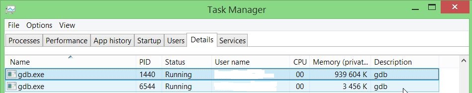

Look at the memory consumption of debugger...

Hello
I updated to CT LAB 5.70 from 5.60 and memory leak issue is now fixed.
Not a big deal, but I found that Ctrl+F11 (Open project) doesn't work. Other shortcuts do work.
