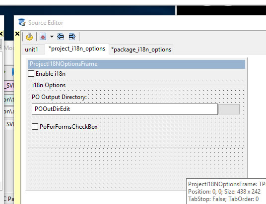

I'm still on CT 5.3, because Project >> options >> i8n >> "create/update .po file" vanished from CT5.4
laz synchronized IDE did GREAT job at building automatic .po files, taking in account BOTH .lfm and .rsj files and i dont know why it is no more available in CT 5.4. That said, i do not understand clearly the ctpobuilder project which takes in account ONLY .rsj files when it works (resources strings) and doesnt care for .lfm files were translatable forms properties are stored.
why reinvent the wheel? the laz IDE does the .po files job perfect when i8n enabled the files are well maintained, you just have to edit and save as other lang the .po files coming from the IDE , why a builder??
In the hope my remarks are constructive
Best Regards and Respect
CT LAB ver 5.50 11 years 2 weeks ago #8021
can you attach a sample form
to work with it ?
Sorry, we find the problem, it's just a form problem
PoForFormsCheckBox is NOT visible in
C:\codetyphon\typhon\ide\frames\project_i18n_options.pas and
C:\codetyphon\typhon\packager\frames\package_i18n_options.pas
so we fix it now,
just disable autosize property of frames and give more height to PoForFormsCheckBox parent...
The following user(s) said Thank You: gulyone
CT LAB ver 5.50 11 years 2 weeks ago #8030
  • gulyone
  • gulyone's Avatar
  • Posts: 100
  • Thank you received: 6
thanks, all went fine after i edited dialog frame! I am now on CT 5.40. maybe a bug in windows autosizing. thanks again!

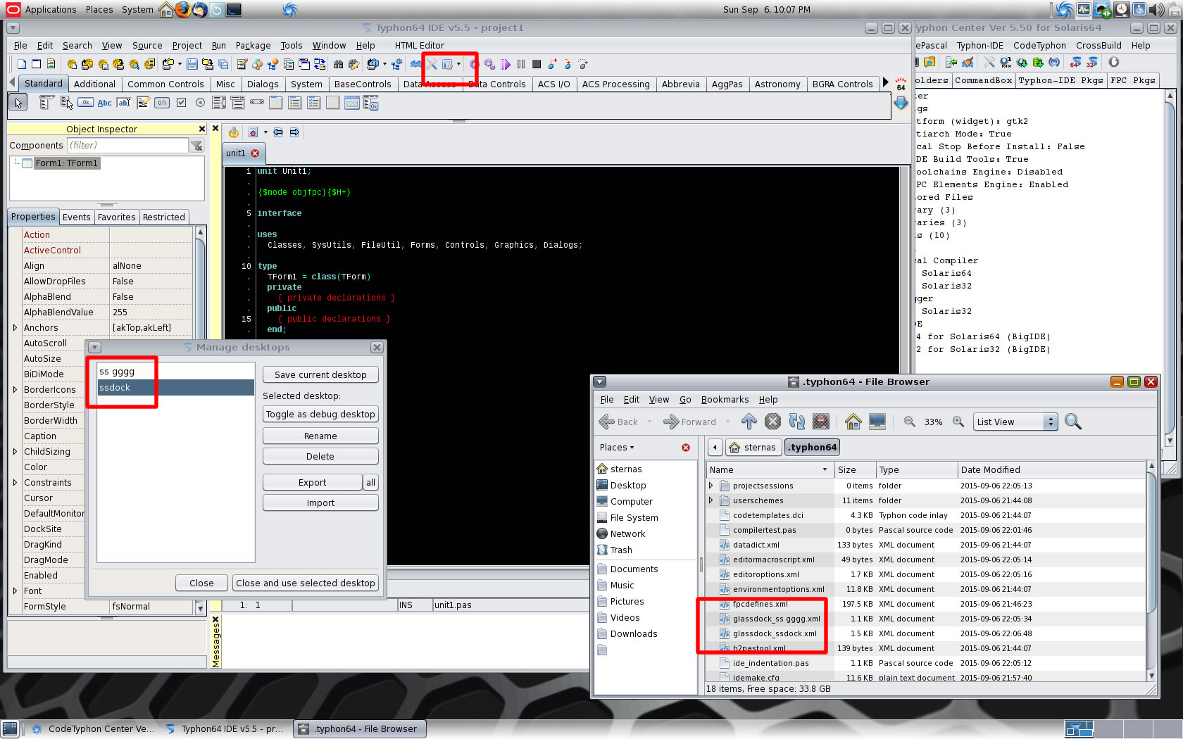

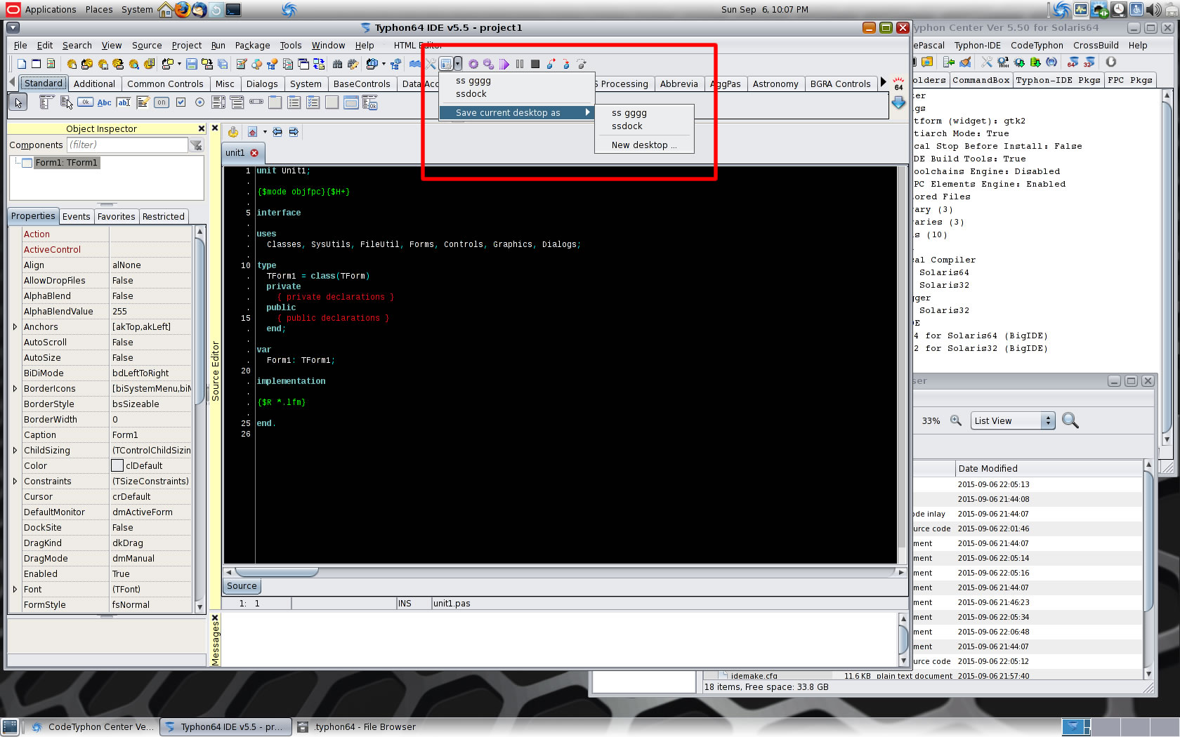

For example the new LAB CT 5.5 revision 005430 (unreleased) has Multi-Desktop Ability and for Glass-Docking System
For this new future, we make changes to some files in CT "User" directories.
PS:
Screens from Solaris 11.2 on AMD64 PC
CodeTyphon has the same functionality on ALL host OSes
The following user(s) said Thank You: FredyCC, atlandev.ct

CT 5.5 RC1 install on debian64. Works :)
I've tested the "Manage desktops". This function only save the windows positions, that right ? not the user settings, yes ?
Will you improve this new ability in the future CT5.5 ?
CT LAB ver 5.50 11 years 1 week ago #8053
Yes Sir
it's a BETA ability
