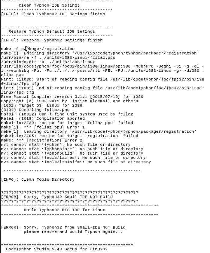

Hello All,
On my opensuse 13.2, i can not finish the installation of CT5.4
CT LAB ver 5.40 11 years 3 months ago #7800
Sir give us more info (if you want our help)
-Did you Install system libraries ? info
-Your OS is 32bit or 64bits ?
-Try to install system libraries and build All with CTCenter and attach here (after zip) the building log info
etc...
CT LAB ver 5.40 11 years 3 months ago #7801
  • atlandev.ct
  • atlandev.ct's Avatar
  • Posts: 52
Thanks to answer.
I follow this topic
www.pilotlogic.com/sitejoom/index.php/wiki?id=205
Sorry, i forgot... opensuse 13.2 / 32b / Asus.
New installation and tons of update at the same time :whistle: . I restart, and give you news.

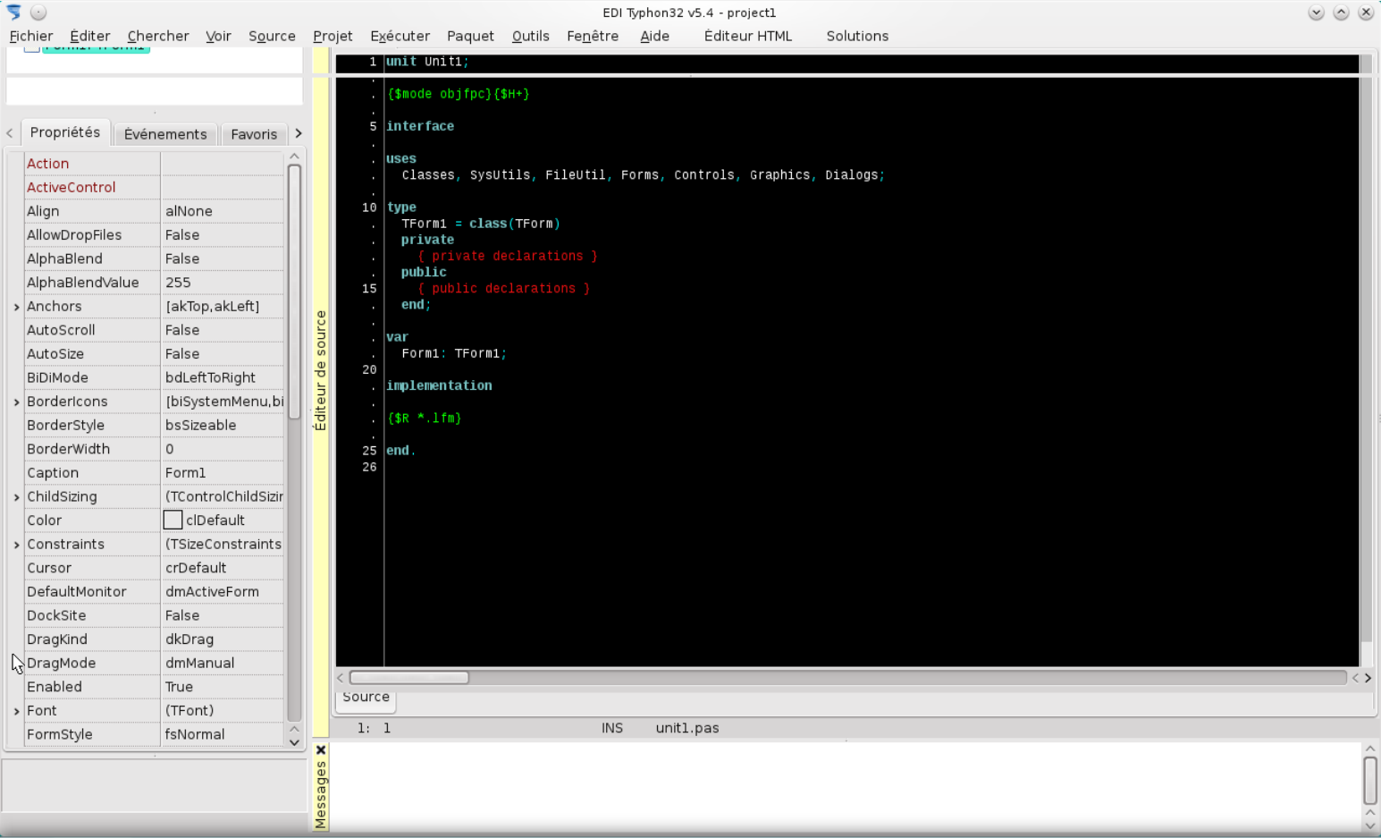

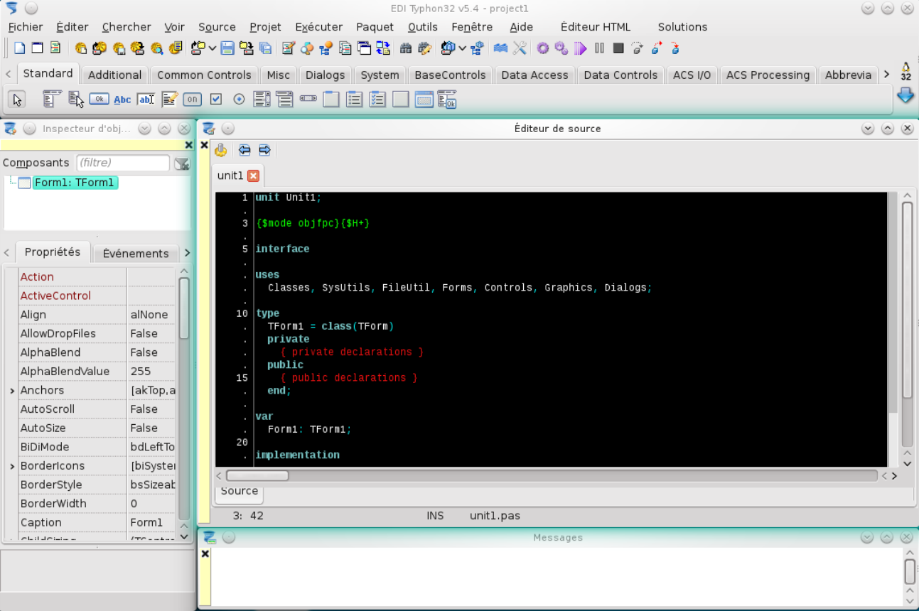

But an another difficulty. When I use "restore default layout docked".
This computer has a 12'' WXGA screen.
Opensuse 13,2 / 32Bits / 3Gb
CT LAB ver 5.40 11 years 3 months ago #7803
Just adjust the height of sub-forms...
but your screen resolutions is to small... :side:
