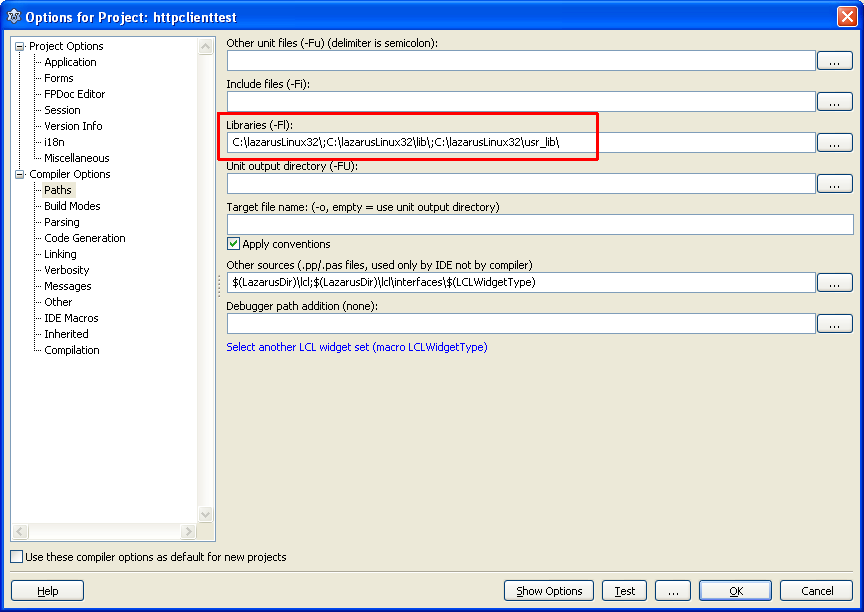

It cross compiles from Windows to Linux, if you supply the Linux Libraries somewhere on the Windows filesystem, e.g. c:\lazarusLinux32\
Just point in the project settings to that directory, as shown in the attached picture.
The libs should actually copied there, from a real Linux system, or from the 7z-Archive, that is attached (that should work at least with Ubuntu, maybe also with Suse and others).

Ok, wanted to ease the pain collecting the files by providing the 7z archive, but here is at least the file list, that was sufficient to cross-link successfully from Win to Linux:
